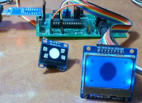

I've completed a fully working version of the graphics library including drivers supporting both the SSSD1306 OLED and the Nokia 5110 displays. I'm using cFunctions to optimise some of the critical code areas and I think the speed achieved now is fully usable for most applications. Obviously more of the basic could be converted into cFunctions to speed it up further and I haven't yet tackled accessing the PIC device registers from C. The downside of cFunctions is that errors typically result in a processor reset making debugging much harder than in basic alone.
I'll attach the code and Cfunction source below but first I wanted to thank Geoff (what you have achieved is extraordinary!),Jim Hiley (mm-edit) and Peter Carnegie (cFuncgen and the tutorial) for creating a great development environment for embedded computing. I've used a fair range of the options out there, picaxe, arduino, Texas Instruments Tiva, etc. but the micromite mk2 together with the cfunction capability is just superb.
The development process I've used for the code is to have mm-edit, notepad++, mplabx, and cFuncgen all open on the computer. The basic code development is done in mm-edit, cfunctions are developed in mplabx, once compiled press the refresh button on cfuncgen and it reads in the new elf file and then press the make cfunction button. Notepad++ immediately recognises that the cfunction basic file has changed and reloads it, then it can be copied and pasted into mm-edit. Using this process a change to a cfunction and retest on the micromite can be done in less than a minute. If cFuncgen doesn't work for you, re-install XC32 and make sure you tick the "add-to-path" box.
There is one common issue with the SSD1306 OLED boards. Many of the cheap boards (even the 4 pin ones) say they are i2c but don't work properly. They do not send the required "ACK" when receiving data. The Arduino community have solved this by producing an i2c library that works without the "ACK" but this is a poor solution. There is however an easy hardware fix. A blob of solder between pins 19 and 20 on the cable from the display where is connects to its PCB connects DIN and DOUT which is one of the requirements for the SSD1306 controller to work properly in i2c mode - check your display and mod if required!!!
My code is a port from the Adafruit graphics library - thanks to them for making their code available. It uses two 128 element 64-bit integer arrays "screen" and "displayed" to map the actual display. The graphics routines modify the "screen" array in the micromite memory and then the "refresh" command writes to the actual display and updates the "displayed" array. In this way the "refresh" command can compare the arrays and optimise what it need to write. I'm using a cFunction to do this compare and this function not only returns the x,y coordinates of the screen element to be updated but also whether a cursor positioning instruction is needed (quite pleased with this )
There are only 6 display specific subroutines required to integrate another type of display: initialise, sendcommand, sendchar, refresh, clearscreen, and cursor position. Both the Nokia5110 and the SSD1306 take an 8-bit data input and write it as a vertical block of pixels within a display row. The Nokia is 48 pixels high and 84 wide so there are 6 (48/8) rows of 84 data bytes required to write the full screen. The SSD1306 has 8 rows with 128 positions on each.
The text routines in the library allow the text to be position in any orientation at any position on the display unconstrained by the row structure. A faster text mechanism could be produced that only wrote within a single row.
I've tested this fairly thoroughly but please let me have details of any bugs I've missed. During the course of this development I've found only one trivial problem in the MK2 code despite it being beta and one out-and-out bug in the XC32 C compiler (shifts on long long variables don't cross the "long" boundary)
The routines support display rotation (separate from text rotation), however, the optimisation of the text functions when the character size is greater than normal do not support a rotated display so text write will be slower if the screen orientation is not "normal". This can be solved but is yet more coding and one has to draw a line somewhere!
If this library is useful I'm happy to act as a central clearing station for any additional cFunctions upgrades or any other additional functions.

Absolutely Brilliant. Really great to see CFunctions being taken up with such gusto.
Hopefully as more people get to grips with CFunctions, the power of a friendly forgiving and immediate environment of Basic coupled with the raw power of compiled 'C' will push MMBasic and uMite into more and more areas.
You can speed up the code/compile/append/download cycle further !
a) In CFuncGen set AutoGenerate ON - then whenever CFuncGen detects a change in the .ELF file, it will automatically do a Refresh and generate the CFunction(s)
b) Every time CFuncGen generates the CFunction .bas file, CFuncGen also copies the text of the CFunction(s) to the Windows Clipboard, so all you have to is Ctrl+V to paste the CFunction into your code MMEdit
c) If you use MCPP and the 'run external' feature in MMEdit, then you just need a #include <path to CFunction .bas file> at the end of your MMBasic program and whenever MMEdit downloads your MMBasic code to the uMite it will automatically'include' in the latest CFunction code - see Tutorial 4 Advanced Topics.
If you do a), and c), then all you need to do is hit the "Blue Hammer" in MPLabX, and then the 'Blue Running Man with torch' in MMedit to have your new code running on your uMite. (in MMEdit set menu Advanced | Auto run on load).
Excellent - I'm going to get some of these displays !
PeterEdited by G8JCF 2014-11-17

When I see projects like this I am glad that MMEdit has been of some use.
Like Peter, I am going to get some of these displays.

In two subroutines drawCircleHelper and drawLine I have put the LOCAL definition of the return from the drawpixel cFunction inside a conditional statement so depending how they get called there will be a "not-defined" bug at run time. These definitions should be moved to a simple declaration "LOCAL dp" at the top of the two subroutines.
This happened when I was changing drawpixel from a basic subroutine without a return to a cFunction - sorry
Best Regards
Peter

New version with significant performance improvements particularly for SSD1306. The fastfillrect cFunction has been generalised to work for any screen rotation (now also used for vertical and horizontal line drawing) and display specific refresh algorithms have been created that use the ability of i2c to send large amounts of data as a single transaction. The "main" program now tests/uses all drawing primitives. A single constant "displayinuse" determines which display to use.
I've now got to stop fiddling with this and get on with something more constructive
2014-11-18_195823_cfunctionSPI.zip Edited by matherp 2014-11-19

Another new version. The variables and functions are now fully typed so it will run whatever OPTION DEFAULT is specified.
The font array is replaced by a data Cfunction - many thanks to Peter Carnegie (G8JCF) for sorting out how to do this. This has saved significant space.
Also variable, subroutine and function names have been shortened to save space.

viscomjim
Joined: 08/01/2014
Posts: 925
Posted: 08:17am 24 Nov 2014
Hi Matherp, this is excellent work. You have been hard at it and we thank you!! Could you give a brief description of how this is used? For instance, how do we display text within a program using this.
thanks again!!!
Posts: 2998
Posted: 10:23am 24 Nov 2014
BRILLIANT WORK Peter!
Will definitely be playing with your latest code as soon as possible.
Can't wait to see how 'fast' this all runs . . . .
Out of interest, where about in the UK are you?
WW
Posts: 2998
Posted: 02:42pm 24 Nov 2014
OK, partial success
I've copied & pasted the code - removed any 'phantom' spaces that appeared and run the program.
Starts of well (displaying all the shapes as they should appear) but when it comes to the text I get nothing at all (no errors reported - just a blank screen while it passes through the loops). The 'Main' loop then restarts correctly - once again showing the shapes; then blank for about 30seconds: this loop keeps going without error.
Any clues or advice to check for things I may have got wrong would be appreciated . . . .
I guess something wrong with the 'pstring' sub (or a sub that it calls)??
WW
micronut
Joined: 03/09/2014
Posts: 37
Posted: 04:07pm 24 Nov 2014
matherp,
Great job! can you post the C source for the newest code as well? I want to try this on my spi based LCD during the long holiday weekend here in the States. Thanks!
