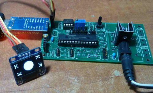

hi i can report first steps for i2c oled and mk2
Mk2 I2c Oled
oled switches on and show some random pixels from the memory inside the module.

great ! the display supports also the 400 khz mode from i2c.
i see math has implement much moore functions as me , so i wait for his source , maybe we can
create some cfunctions for this oled.
cant wait to see your code matherp , are you sending the memory byte for byte or using an array ?
i think we can speedup the memory transfer if we use a 2kb array and store the "data"command every 2 bytes. after this a cfunction call grab the imagebuffer and split it also to the 2k memory.
now sending is easy because we have a array with data command and data bytes in.
i dont know what is faster , using this methode or changing the setpixel routine to create the same effect.
