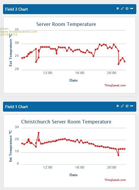

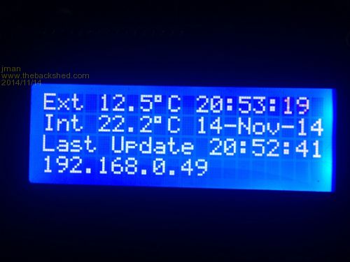

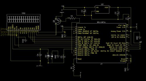

Here is a little project I have been working to monitor the temperature in our server room at work. We hardly ever go in there so I thought we better keep an eye on the cooling.
I chose to display the temperature and some other info on a 20x4 LCD this will mounted in the server rack. Should a fault occur the Micromite will send an email to me every 4th cycle (this is a user setting). I am using 15 minutes at present so i get an email every hour. The temperatures are uploaded to www.thingspeak.com every 15mins. To use this you will need to create a free account @ www.thingspeak.com and put your api key in the relevant place. To connect to the internet I am using an ESP8266 Wireless module these are really cheap and easy to use. Put your Wireless SSID and password in the relevant place if your connection is successful the terminal and LCD will display the assigned IP address.
Sample screen shots below. The shown temperatures are not the server room temperatures they are my outside my window and the test bench :)
The date and time are from the returned connection string the thingspeak.com sends back the temperature sensors are DS18B20's
Please take a look and post here if you see any dumb mistakes or things that could be done better.

PWM 2, 1800, 5, 20 'Adjust Freqency for contrast adjustment
directly connected from the uMite to the LCD pin 3 to adjust the contrast instead of the usual 10k pot from ground to +5v? If so, does the 3.3v output work ok for that?
jman
Joined: 12/06/2011
Posts: 711
Posted: 08:43pm 18 Nov 2014
  viscomjim said   Hi Jman,
Quick question... are you using this
Well spotted
This way I can run the LCD from 3.3v and still get good contrast
take a look at this 3.3v Contrast
Let me know how you get on
Jman

jman
Joined: 12/06/2011
Posts: 711
Posted: 11:04pm 18 Nov 2014
@viscomjim
This the code I use for the Backlight
Sub SetBrightness ' Sub To Brightness
PWM 2, 1000, (100-Brightness)
End Sub
And connected like this
If you run the LCD on 5v you can give this a try for the contrast
(Untested a UMite but tested on 16f88)
You might have to adjust the resistor values.
Really keen to see the email code it's great to share
Jman
