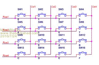

I often find myself connecting a few buttons to a MicroMite.
3 or 4 sometimes even 8-9.
Unfortunately that cost a lot of pins (and resistors*) when connecting them directly.
For that reason i like to wire them with columns and rows, exactly the same as a keypad is used only with less rows and columns.
To use them i have to write some code that scans the rows and columns.
Seems redundant when there already is a keypad command.
Ideally being able to use as little number of pins as possible. Even connecting one button by defining only one row and one column would still be nice because it will be debounced.
Now the KEYPAD command needs at least 7 pins. Maybe another way to provide the pin numbers could be considered. There are two options that i can think of now.
One is using the number 0 for an unused row or column. The syntax stays exactly the same, the firmware would need to recognize the 0 as an unused row/column.
Another variety would be to only supply the number of pins that are needed. This requires more documentation.

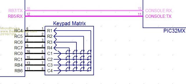

For something external i made a little mcu that decodes a matrix and outputs it to the serial port. This serial port is then connected to the RX from the console, so the keys kan just be read with input or inkey$.
The console RX is connected to the output of a little 'OR' gate which allows characters from the USB/Serial terminal or from the little mcu.

Posted: 06:08am 24 Jul 2016
I am currently testing something different that might make a good solution for adding switches/keypad.

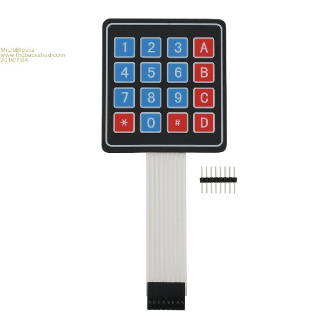

I have added the code for scanning a little matrix to my USB/Serial converter.
It has an 8 pin connector that directly connects to those membrane keypads that have a 4x4 matrix.
like this one:
You can also use it to connect switches of your own, just wire them as a matrix. 1 key to 16 keys supported.
The extra code scans the matrix and injects a switch/keypad code into the outgoing serial buffer.
The micromite will receive it over the console rx and can treat it like any other key just as ones that are pressed on your pc's keyboard when using a terminal.
I am considering to use the normal ascii codes for it, or as an alternative send ascii codes 200-216 to distinguish between keypad and pc keyboard.
