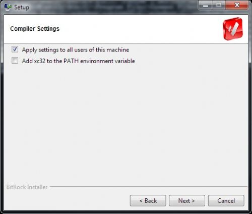

That was it. I manually added the compiler directory to my user path and it worked straight away.
I also reran the installer and noticed that there is an option to add X32 to the path and it was unchecked. Can't remember if it was this way the first time I ran it.
