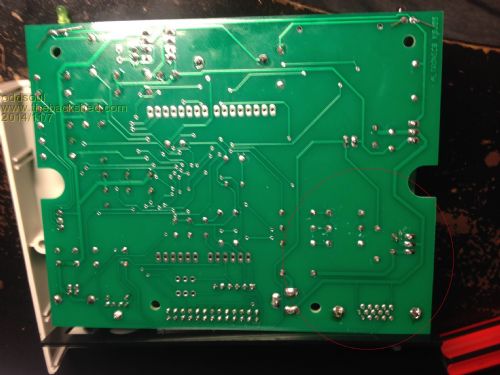

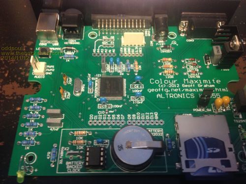

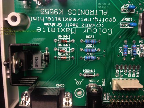

I have 2 images of the PCB showing both sides of the board.

Everything looks OK but my aging eyes have enough trouble checking resistor colour codes in the flesh, much less looking at a photo.

I copied the image, magnified it by 50% and I can read the resistors. They are (right to left in the image) Brown Red Black Black Gold = 120 ohms. The diodes are the correct way according to the overlay.
In the absence of measurement, it's time to start substituting. Try a replacement cable and monitor. One sub at a time please.

Well after all this time the issue was finally fixed
New Resistors:
Old Resistors:
If you look at the resistors in both images they were setup in the wrong orientation
-120Ohm were in place of the 10K and that was why the video output and clock were not working
Thanks to Geoffg for helping me with the issue.
I think we all need to stop and look and look again so we make sure that these things don't happen! But it still was a good experience!!
