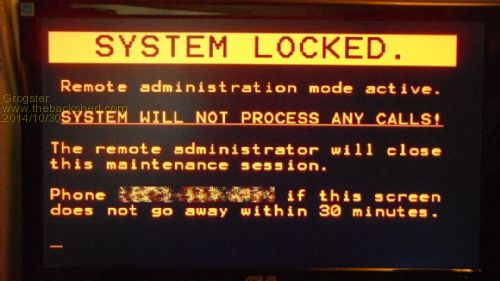

Playing around with the VT100 tonight. I plan to use this as a static message display when I use the Internet to remote-administer a CMM-based system. The VT100 board shows this message, and switches a KVM switch to switch the actual VGA side of things, and also isolates the local keyboard, so staff can't interrupt or otherwise upset the remote access of the system.
I have blurred-out the phone number for reasons of privacy, but I really do LOVE these two large text modes on the VT100 terminal.
Image looks orange, but that was the camera and low-light. Text is bright red.

It has a nice retro 1970's look to it.
Btw if anyone using Geoffs VT100 doesn't need the USB function, you can use an MX150 chip instead of the MX250. I've yet to try the MX170.
