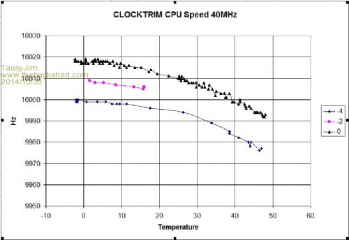

I have been doing some investigation into the accuracy of the internal oscilator in the MX170 chip.
Microchip data sheets mention the drift figures but don't bother supplying any charts to help visualise the stability.
My test equipment consists of an old 12V car cooler/warmer. It can cover the temperature range of zero to 48 degrees C.
There is a micromite in the cooler with a DS18B20 recording the temperature.
I set a PWM of 10kHz and vary the temperature for various CLOCKTRIM settings.
There is a maximite outside the cooler and it measures the frequency of the PWM.
I also have a standard frequency meter in line and so far the maximite and frequency meter have agreed.
It takes about 2 -3 hours to do a full temperature run for each CLOCKTRIM setting.
The frequency of the oscillator depends on the internal temperature of the MX170 so it will depend on ambient temperature as well as the internal heating due to workload.
I tried with a PWM frequency of 100kHz and the frequency was lower than the expected 10 times the 10kHz freq. for that ambient temperature. Higher internal temperature gives slower speed.
When I have finished this set of readings, I will try with different CPU speed settings. I expect a CPU speed of 5Mhz will result in higher PWM frequency.
This chart is the results this morning.
All the readings are well within the quoted accuracy but if you want an accurate clock, you will need to use and external RTC.

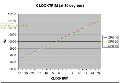

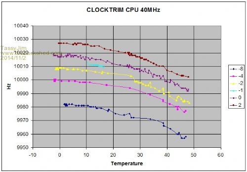

I have finished playing around with CLOCKTRIM.
2014-11-02_012501_Frequency_stability_of_the_MX170.pdf
The first chart shows the stability of a PWM output set at a nominal 10kHz over the range of zero to 48 °C
The test was run for a number of OPTION CLOCKTRIM settings
Below about 20 °C the frequency was very stable. Above 30 °C, the frequency changes considerably with temperature.
At the higher CLOCKTRIM settings, the CPU speed does have a slight effect.
A change to the CLOCKTRIM setting of one results in a change in frequency of 4Hz
Conclusion.
For ambient temperatures from zero to +20 °C, a CLOCKTRIM setting of -3 or -4 will improve accuracy considerably. At higher temperatures, the change due to temperature variations would make finding a suitable CLOCKTRIM setting difficult.
Over the full range tested, the frequency change was sill less than 0.3% for any CLOCKTRIM setting.
The frequency stability is more than adequate for most uses but a true RTC is needed for accurate time control.

simplest answer: will the required value be different for each individual MX170 processor? if yes, then it would probably be best stored in the lines of basic code.
addendum: looking at the above graphs again, my opinion is swayed towards it always being set in program code so as to maintain visibility. also, it is something that is best set dynamically, depending on ambient/die temperature.
