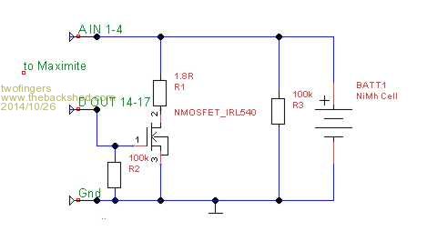

1x (simple, used?) battery charger housing w. 4 slots for each slot:
2x 100k (pulldown)
1x 1.8R/2W (current limiter, current ~500-670mA)
1x IRL540N* (logic level N-MOSFET, switch)
1x perfboard, some small cables,
1x flat ribbon cable w. 26p GPIO connector
(e.g. old PC printer MB adaptor)
(* should also work with a IRML2502 (SMD), but a IRL540N seems more robust - just in case)

Schematic (you need this four times)

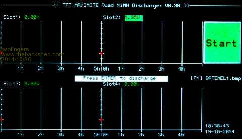

The TFT start screen:

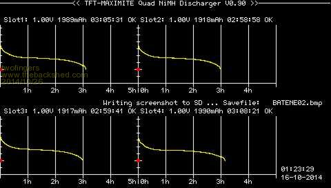

The TFT output screen (AA eneloops):

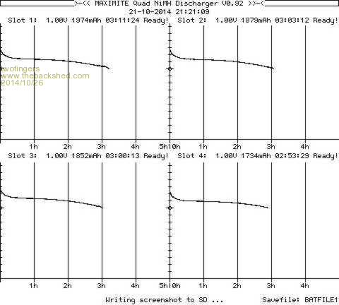

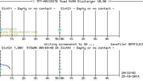

The TFT screenshot:
a non TFTMM screenshot:
