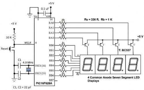

Hi Grogster,
see this picture:
You can see the µC outputs of the controller on the left side and the switched cathode on the bottom.
Frank
Posts: 10108
Posted: 11:20pm 23 Oct 2014
Ahhhhhhh - I see now.
A picture speaks a thousand words.
Would I then be correct in my assumption that the data-lines for the segments, and the cathode transistors are switching very fast - too fast for the Human eye - so it looks like a static 4-digit display, using your image?

Frank, that is a very cool representation. Can I congratulate you?

You are right!
@Greame:
Thanks a lot but I only found it on the net with Google picture search...
Frank

Posts: 2984
Posted: 01:51am 24 Oct 2014
Frank,
A fantastic image, shows beautifully how it all works.
Grogs,
Yes only one segment is actually displayed at a time but the multiplexing is done so rapidly the eye cannot see the flicker. Well that's the theory.

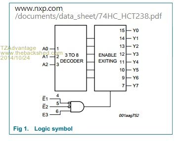

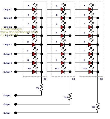

Posted: 04:13am 24 Oct 2014
There is another way but that only works for maybe 2-3 displays from MMBasic.
It will probably works for more displays when a C plugin is used.
This needs a warning though! If the program is not exact it can cause damage to the mcu or displays. So take care when you are going this way. Test the outputs before connecting the displays!
Basically what you do is using 7 output ports, one for each segment. (8 when you also want to use a dot)
The common cathode is then connected through a resistor with a output pin that will be used to select the right display. So one output pin for each display.
like this:
It works when ONLY ONE one of the 7 output pins is high and ONLY ONE of the select outputs is low.
Principle of operation is to start with all output pins connected to the segments low and the output pins connected to the common cathodes of the displays high except the one you are using as the first display. Then set the output connected to the right segment high to make it light up. Then set it low again and do the next segment. When all segments that should light up are done set the selection pin high. Then repeat for the next displays. Beware!! Never light up more then one segment!!
Advantage is very little extra components (1 resistor!).
If you have less pins available you can use a 74HC238 to decode 3 pins to 8. This will actually prevent against programming errors as only one output pin can be active high at a time.
If you need more display then you can also use a 3-8 decoder like the 74HC138. This functions the same but is active low.
If you use both the 74HC238 and the 74HC138 then you can have eight 7-segment display with only 6 output pins. :) As long as you can change the pins fast enough.
Rmember this is not the normal way to connect 7-segment displays but can help when you not have enough pins or not enough room on the pcb.Edited by TZAdvantage 2014-10-25

Posts: 2998
Posted: 06:45am 24 Oct 2014
There seems to be some confusion in this thread.
Grogster's original post asked why effectively the circuits typically use transistors to drive the cathode of each digit (as opposed to connecting the cathodes directly to ground).
Taking the transistors out of the equation for now you end up with Frank's brilliant animation that he posted. Simply put, this is multiplexing each digit at a time. For this you will require 7 MPU outputs (one for each segment) and an additional number of outputs that equates to the number of digits you have.
Transistors just give the ability to switch the appropriate current that the LED digits will require (if all 7 segments are on i.e. displaying the number '8', then as much as 200mA needs to flow through the cathode. This would kill a MicroMite if no transistors were used!
To answer Grogster's question about 'Why not directly connect the cathodes of the digits to ground - then doing this will simply result in all digits displaying the same 'character' depending on the state of the 7 MPU outputs driving the segments. i.e. this is NOT multiplexing.
If for whatever reason you wanted to ground the cathode of each digit then you would need to have an MPU output to drive each segment in all digits (so 42 outputs for 6 digits when not multiplexing, or 13 outputs when using multiplexing - as per my original post)
The above is for Common Cathode displays - don't forget to 'reverse' things for Common anode displays
Another option for driving 7-segment display is to use something like a 4511 support chip. This is a bcd to 7-segment display driver and in certain situations can be beneficial requiring only four MPU outputs connected directly to the device's four BCD input pins.
(@Grogs: I'm trying to write 1000 words to save having to post a picture. I'm not as 'artistic' as Frank! )
