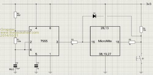

OK folks, I have built a test 7555 circuit, which seems to be working well.
The 7555 operates as an astable with R1, R2 and C2 setting a time period of about 35 seconds. R3 provides some current-limit protection to the MicroMite, and D1 prevents the 7555 from tripping the MicroMite via S1 during it's timing cycles. The MicroMite is woken every timer cycle, where it checks the condition of the battery, then goes back to sleep. The idea behind all this, is to maximize battery life, by not allowing the CPU to run all the time, sucking juice from the battery, while doing nothing but waiting for a button press.
If S1 is pushed during a sleep cycle, D1 pulls the WAKEUP pin low and wakes the MicroMite allowing it to process the button press. During S1 presses while the MicroMite is awake, the 7555 is still running in the background, but as the MicroMite is now awake, it just ignores the 7555 output till the MicroMite is put back to sleep again.
Can anyone see anything obviously wrong with this setup or suggest a better idea?

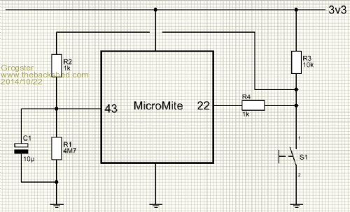

EDIT: OK, with 10uF tantalum and 4M7 resistor, I am getting about 45 seconds sleep time. If I went down this road, I would be using an X5R 10uF MLC capacitor - the same cap I use for the uM Vcap. Being X5R, it should be reasonably stable over time and temperature.
EDIT: OK, I seem to have found out that under certain circumstances, the uM seems to just stay asleep forever. When I try to use my button to wake the uM, it does not wake, then it NEVER wakes. Example: Apply power, run code. uM starts sleeping and waking as it should. While asleep, try to wake it with the button across the wakeup pin and ground, uM does not wake, and then the uM NEVER wakes no matter how long you wait. To get it back, I have to cycle power or press the RESET button(I'm using a WW 44-pin module)
This does not happen with the 7555 driver circuit. Witht the 7555, the uM sleeps and wakes on command, and also can be woken any time with the button.
Something about the cap + reistor idea which does not want to work in a reliable sence, as was initially pointed out by Geoff.

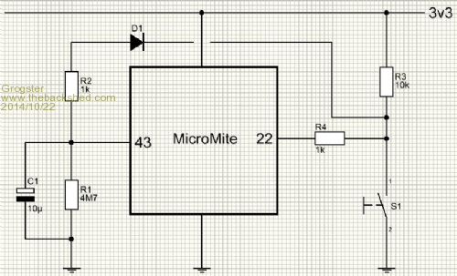

EDIT: Ahhhhh - forgot the 1k series resistor between the WAKEUP pin, and the switch to ground. I can wake the uM on button press now.
EDIT: OK, here we have the circuit as it stands now, and this seems to be working fine, including waking on command when S1 is pressed.
Edited by Grogster 2014-10-23
Posted: 07:49pm 21 Oct 2014
i tried it with a 3M3 resistor, and it appeared to work - though i do feel the value could be a tad high. it all depends upon the leakage current between Vcc and the wakeup pin; the resistor needs to drain much more than the leakage current (at least 10x, preferably 100x).
it is good to not have the capacitor too large, as upon each wakeup it needs to be fully charged, which is depleting your battery. i was seeing a 10uF capacitor fully charged up in less than 10mS, and did the maths to compare.
the energy that has to be put into the capacitor is
U = (1/2) x C x (V^2)
U is in units of joules. this is the same as watt.seconds, as:
P = U / t
=> U = P x t
=> P x t = (1/2) x C x (V^2)
if C = 10 x 10^-6 farads, and V = 3v3, then U = 0.00011 joules, or 0.00011 watt.seconds of energy stored in the capacitor. we know that the formula for power (watts) is:
P = V x I
=> U = V x I x t
and that for a micromite pin the current is limited to something like 20mA, so:
0.00011 = 3.3 x 0.020 x t
solving for t gives:
t = 0.00011 / (3.3 x 0.020)
=> t = 1.7mS
this assumes all the energy goes directly into the capacitor, which given we are using (effectively) a constant-current source to charge the capacitor is not true. the capacitor voltage ramps up linearly, with excess voltage dropped within the micromite. a fair approximation would be 50% energy efficiency, pushing out our charging time to more like 3.4mS or thereabouts.
the conclusion is that with a 10uF capacitor, for each capacitor recharge you will be draining 20mA from the battery for about 4mS. or the equivalent of 80uA for 1 second; 40uA for 2 seconds, 8uA for 10 seconds, 3uA for 30 seconds.
rob :-)
Posted: 07:52pm 21 Oct 2014
question: why are you using two pins?
rob :-)
