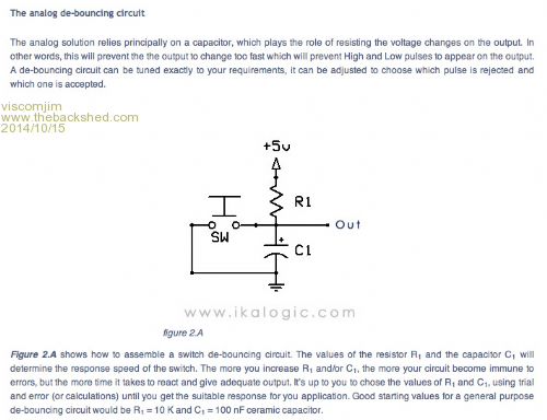

I have used this with no problems, works weil with uMite...
R1 = 10k
C1 = .01uf or .1uf

viscomjim
Joined: 08/01/2014
Posts: 925
Posted: 06:53am 15 Oct 2014
I typically do SETPIN XX, INTL, SWITCHINT.
XX being the pin number and SWITCHINT being the interrupt routine I want to execute.
Here is some info from this forum.Edited by viscomjim 2014-10-16

viscomjim
Joined: 08/01/2014
Posts: 925
Posted: 03:50pm 15 Oct 2014
Hi Atmega8, I also use this setup on both sides of a rotary encoder using the built-in function on the uMite and it really cleans things up easily. Nice smooth increments (or decrements).

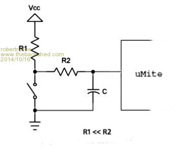

Posted: 01:19am 16 Oct 2014
someone earlier posted a link to a page containing this circuit:
it addresses your concern about shorting out the capacitor (in theory a quite valid concern), and provided R1 is much less than R2 then ramp up and ramp down times will be fairly similar. the micromite digital inputs almost certainly go through schmitt triggers, so this circuit will work well.
t = 0.7 x R x C (approximately)
for t = 1mS, reasonable values would be R1 = 1k5, R2 = 15k, and C = 0.1uF. while the button is held pressed about 2mA will flow if R1 = 1k5.
rob :-)

Reading through the whole 26 page text of the link that Gizmo posted earlier:
http://www.eng.utah.edu/~cs5780/debouncing.pdf "A guide to De-bouncing" that looks right-on Rob.

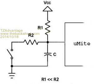

Posted: 10:54pm 17 Oct 2014
My entry to the "competition":
[Modified picture from Rob]
!Note R1 = 4 x R2.
While the switch is closed it draws less power as both resistors are in series.
The two resistors are a basic voltage divider when the switch is closed, so it works even with an analog input.
Because it being a voltage divider R2 needs to be small enough to get a 'low' on the input pin. My estimate is that R1 has to be about 4-5 times higher in resistance then R2.
In battery operated systems that have switches that can be closed for a long time it will give some more live.
Edited by TZAdvantage 2014-10-19
Posted: 02:15am 18 Oct 2014
  viscomjim said   I am now curious to see which one actually works?
under most circumstances, they both probably will perform equally well. with the switch shorting the capacitor directly there will be a very small arc if the contacts bounce, which will serve to maintain the short throughout. but this arc will be so small as to do no real damage to a switch actuated by a person.
however...
some years ago i set up an experiment to monitor startup durability of a power supply design. startup was normally initiated by a conductive-rubber push button being pressed by the operator, but for the purposes of the experiment this was replaced by a rather large relay driven by a timer that fired briefly every 10 seconds. the output of the power supply was connected to an electro-mechanical counter. because the power supply had no 'heartbeat' signal being sent back to it (from the rest of the product), by design it would shut down automatically after a few seconds.
the end result was that every 10 seconds the power supply would be turned on, which would then increment the counter. after a few seconds it would turn off. the power supply itself was sitting in a thermal oven, that over a period of several hours would cycle between a high of 85 degrees C and a low of -10 degrees C. every day i would check the counter was still going up and that nothing had exploded.
to my complete bewilderment, after about 8 months (heading up towards 2 million cycles) the setup stopped working. i traced the failure to the (20A) relay contacts connected in place of the power switch, which were massively eroded. the relay had 3 sets of contacts, with only the one set being damaged.
the conclusion - root cause analysis: the tiny capacitor in the switch debouncing circuit (just a single resistor and a capacitor) had very very slowly eaten away the relay contacts through the around 2 million tiny arcs the experiment had created.
the moral of the story: if you expect your switch contacts to be closed several million times over the life of your project, it would be prudent to use a second resistor. but, in practice, this is only likely to be an issue if some sort of machine is actuating the switch repeatedly.
rob :-)

Having read the above link again I'd qualify my "right-on" comment to, right circuit but resistances too low. Pages 12 to 16 of this link discusses this circuit and he gives some pretty valid reasons to include R2. He recorded digital scope traces from 18 different types of switches (photos on page 2) and each switch was opened and closed 300 times to get a good sampling. Page 4 shows average de-bouncing times for opening and closing for each switch type and the times are surprisingly long in some cases. Most were somewhere under 10 mS but quite a few were 20 to 50 mS - one particularly bad one was 150 mS.
He shows some example calcs using 20 mS as the time constant because of the results of the above tests. Using a 0.1uF cap and 5v, it gave 180K for R2 and 18K for a 1uF cap. He considered 0.1 uF to be a bit low (reasons given) but for the PIC32's maybe it's OK. (He did this work in 2004 and noted that "most microprocessors don't have a schmitt trigger input". Because of that he suggested a CMOS 74AHCT14 hex inverter as the schmitt trigger input - but we don't need to do that.)
TZ's point about being able to use his circuit also as a voltage divider has merit but the point about drawing less current because of R1 & R2 both in series with the switch closed seems less useful - if R2 is a lot lower value why not just lift R1 a bit. Issues around maintaining the logic 'low' in that circuit is something for you proper electronic guys to ponder
Greg
