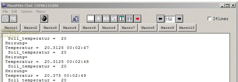

I am missing some Icons in the Chat window, when changed to 115200 baud..
Posts: 6609
Posted: 10:21am 13 Oct 2014
Some icons are hidden when in VT100 mode.
They will all reappear when you switch to ASCII or HEX mode.
