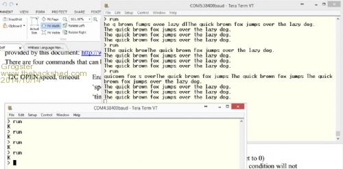

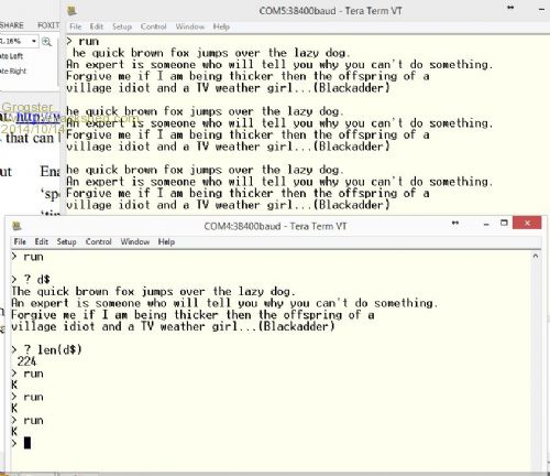

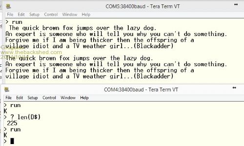

Of course. I just wanted to be complete so others could reproduce the problem.
As with all the "Saved Vars" one really only has to do them once, or at least only when they are changed. In this "Testing" phase I needed to be able to quickly change them, more or less, on the fly.
  Quote  But the real problem is the I2C issue and your program makes it impossible to identify just what the problem is. It requires the tester to setup a test hardware with LCD, etc then reverse engineer your program to understand what is going on.
Actually, the LCD part is not failing at all, except when passed bad parameters.
Just comment out, in the Slave Program, Lines 8, 9, and 26, the 3 lines that operate the LCD.
All data that would be sent to the LCD is echoed to the console so I can see what is going on.
I'm running TeraTerm with a single RS-232 to USB interface. I added a DPDT switch in the RS-232 lines so I could easily switch between the Master & Slave consoles. This works well as I can quickly program each uMite and monitor their consoles.
I formatted each uMite output to the consoles so both Master & Slave data line up. This way it is easy to compare the two outputs.
  Quote  You need to distil it down to a dozen or less lines that demonstrates the issue without requiring unnecessary hardware.
Ok, The problem is almost certainly in the Slave lines 20..29. This is where the I2C bytes are being caught from the bus.
I'm using an I2C sniffer, that cool tiny scope by Gabotronics called the XProtoLab to monitor the I2C bus. Every byte the Master sends is correct in every detail. Therefore, I think the problem must be in the Slave interrupt routine.

How do you specify the uM slave bus speed?
You can set the master speed, but there is no option in the slave commands for telling MMBASIC what speed bus it has. Perhaps the slave commands default to 100kHz speed or something, and if that is the case, then setting a faster master speed would no doubt cause garbled comms between the two.
I am playing with this idea at the moment....

I2C slave speed is just that. It is a slave to the master in clock speed also. It syncs on the clock provided by the master.

In my experiments thus far, I have got no results at all at 400kHz speed, but am getting results at 100kHz.
MASTER:
[code]
I2C open 100,100
D$="12345678901234567890123456789012345678901234567890"
D$=D$+Chr$(13)
I2C write &B1010101,0,Len(D$),D$
I2C read &B1010101,0,1,B
Print Chr$(B):D$=""
End
[/code]
SLAVE:
[code]
I2C slave open &B1010101,0,0,TXD,RXD
Do:Loop
TXD:
I2C slave write 1,75
Pause 50
IReturn
RXD:
I2C slave read 1,B,N
D$=D$+Chr$(B)
If B=13 Then Exit Do
Loop
Print D$:D$=""
Pause 50
IReturn
[/code]
I have a feeling, that when used in a master/slave arrangement like this with two uM chips, you may well have to send data byte-at-a-time with acknowledge rather then just throwing the string at it. I am about to play with that idea now.
Posts: 6609
Posted: 05:33pm 13 Oct 2014
The I2C command has no idea how much data is arriving, only the amount you want to read.
I2C can be treated a lot like RS232 data.
If you know how many bytes are coming in, you can wait for that many but you need to consider the case of transmission being interrupted.
If the I2C routine waited for the number of bytes you have specified (84 in your case) the program will hang if fewer that 84 arrived.
The Rcvd variable gives you the actual number of bytes received without the risk of program stalling.
You could read one character at a time and check for an end of line or similar or check the Rcvd value and if it is less than the number you wanted, go back and read again. This is quicker than setting a long delay but you still need to cover the loss of all transmission.
Posts: 10048
Posted: 05:41pm 13 Oct 2014
I am able to get reliable results with the clock set to 10kHz. Any faster then this, and the comms are garbled. This is byte-at-a-time writing. Master sends a byte, then waits for slave to acknowledge, then sends another, till it runs into a CR, then it stops. The tinkering continues....
EDIT: OK, I have it working now right up to 400kHz.

Posts: 10048
Posted: 06:23pm 13 Oct 2014
Working at 400kHz with a string 224 bytes long.
MASTER:
[code]
I2C open 400,100
EOL$=Chr$(13) + Chr$(10)
DA$="The quick brown fox jumps over the lazy dog." + EOL$
DB$="An expert is someone who will tell you why you can't do something."
DB$=DB$+EOL$
DC$="Forgive me if I am being thicker then the offspring of a" + EOL$
DD$="village idiot and a TV weather girl...(Blackadder)"
D$=Chr$(85)+DA$+DB$+DC$+DD$+EOL$
For X=1 To Len(D$)
I2C write &B1010101,1,1,Asc(Mid$(d$,x,1))
I2C read &B1010101,0,1,B 'Wait for slave to acknowledge byte
Next
I2C write &B1010101,0,1,27 'Send end-of-data byte
Print Chr$(B)
End
[/code]
SLAVE:
[code]
If B=27 Then Print D$:D$="":B=0
Loop
TXD:
IReturn
RXD:
D$=D$+Chr$(B)
IReturn
[/code]
We're always missing the first byte of the message - not sure why at this stage, but if it was consistent, then a dummy byte could always be used for byte one.
EDIT: I have fixed the missing byte one, by adding a capital U to the start of the data string, as a data-slicer sync kind of thing. No missing characters now.
Edited by Grogster 2014-10-15
