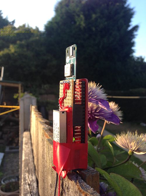

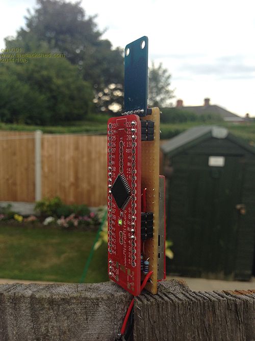

EDUPIC1 High Altitude Balloon tracker first successful flight completed
44 pin Micromite Lite from micromite.org
uBlox Max8 GPS module
Radiometrix RF Transmitter
DS18b20 Temp sensor
Single 1.5v AAA Lithium Energiser Battery
The DATA is compiled into a string and transmitted in RTTY over RF in the following format
$$EDUPIC1,941,12:59:55,5141.98759,00133.86900,09,18493.3,0,- 31.5,1.3*C538
$$payload,count,time,lat,long,sats,alt,flightmode,temp,batte ry volts,crc
Suspended on a small helium balloon it reached an altitude of 25,777m and a temperature of well below -30 degrees
Another flight is planned in the near future to an altitude of 36,000m +
Thanks to the WhiteWizzard for his invaluable assistance with coding :)

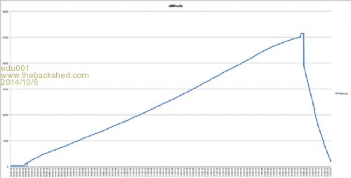

Here is the received DATA over time for 1 flight
2014-10-06_151046_EDUPIC1_Example.zip

Holy Cow that awesome. Looks like 6.5 hours flight time? Which radiometrix transmitter gave you that range on small powersupply and what did you use for a receiver? Also, do you need any kind of agency clearance to let a balloon go like that?
I looked at your flight information zip file. How do the lat and long numbers work? I tried to google the numbers but had no luck.

Some more details on the tracker
The setup is
ublox GPS connected to COM2
Radiometrix MTX2 transmitter connected to COM1
I read the correct NMEA sentence from the GPS filter out the unwanted fields/sentences and compile it into a string which is sent to the MTX2 for transmission on 434Mhz a 10mw signal can be received over hundreds of kilometers
There are quite a few receiving stations all over europe we decode the RTTY using fldigi software and send the data over the net to Spacenear.us check it out it will all make sense
The balloons are quite small this one is a foil
Launched on Saturday it covered 822km at 7000m ill post the details on that flight as soon as I have the data

Having worked with Jed on this project; mainly power saving techniques and a complex CRC code module I am in a position to elaborate on the above and how we maximised the battery life.
The 'set-up' comprises of a 44-pin MicroMite module plugged into an expansion board; the layout of which Jed takes full credit. On this stackable expansion board is a high quality GPS receiver, a high quality RadioMetrix Radio Transmitter, a standard PCF8563 Real Time Clock, and a very efficient StepUp booster.
High level operation is as follows. The MicroMite is normally in 'Sleep' mode. Periodically the RTC will wake the MicroMite which then immediately wakes the GPS module. The current GPS location is read along with some other data. The GPS is then put to sleep and the Radio Tx woken. A string of data based upon GPS co-ordinates, GPS altitude, and GPS Time is compiled and then transmitted at 50baud via the Radio Tx. The Radio is then put to sleep along with the MicroMite; ready for the next 'WakeUp'. During the time the MicroMite is awake, it is set to the appropriate CPU speed depending on the function it is performing - all in a bid to minimise average current drain.
The GPS has a typical current draw of upto 20mA while 'awake', and a similar current draw for the Radio module while transmitting.
On a wakeup every minute, the overall battery-life is a matter of days - remembering we can parallel batteries to provide longer flight times (but obviously at increased payload weight).
This project has been very interesting to work on and hats off to Jed for an excellent combination of hardware to achieve something very impressive.
I look forward to Jed's posts as I know he has many more stories to tell you all regarding his 'flights'.
As this is Jed's 'baby' I will let him keep you all informed with updates and will only chime in when I feel necessary!
For those really interested, we will be making the hardware available to everyone very soon so that you can begin to fly your own balloons . . . .

  viscomjim said   Holy Cow that awesome. Looks like 6.5 hours flight time? Which radiometrix transmitter gave you that range on small powersupply and what did you use for a receiver? Also, do you need any kind of agency clearance to let a balloon go like that?
super impressive!!!!!
That is what I read from the uBlox (google DDMM.MMMM) GPS then I do some calculations to get Decimal Degrees
The flight we just did lasted 12 hours+ then went out of range it had about 40 hours battery life

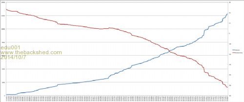

There seems to be a cold layer at lower altitudes, this graph shows how cold it can get I tracked it to -61 but the data was erratic but the Micromite was still running I think the battery froze :)
Data file 2014-10-07_062522_cold.csv.zip

OK, I checked temperature out.
edu001's (Jed?) balloon got to got to 25,777m which is pretty much fair in the middle of the stratosphere (12-50km altitude). Temperature does indeed start going up again when you get up to about a third of the way into the stratosphere - up till then it's been around -60C from about 12km altitude. It keeps increasing till it hits 0 deg C at the top of the stratosphere - about 50km up, so the -35oC reading he's getting at 25,777m is probably pretty close to the mark! The battery operating through these temps (to say nothing of the poor little MicroMite and the other bits) is pretty surprising. It'd be interesting to see what the battery voltage was doing through all this!
This gives a good rundown:
Atmosphere temp etc
Greg
EDIT: well I didn't need to look far, the voltage was in the log Jed gave us to download (I didn't open it till after the post). Doesn't look like the -60oC area affected it a lot at all.
EDIT 2: Err... correction again; that temp log only went to 12,000m, about where jets fly, and showed 1.0 volts with air temperature at -51oC. How low can the voltage go before the supply 'carks' it?Edited by paceman 2014-10-08
