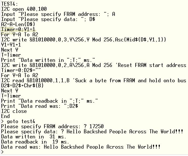

Posts: 10108
Posted: 08:33pm 30 Sep 2014
Edited by Grogster 2014-10-02
