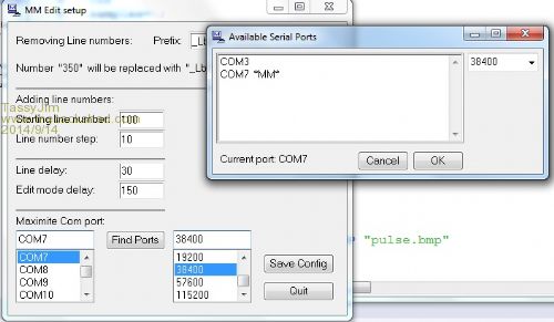

Posted: 01:38pm 14 Sep 2014
If I was looking for a VT100 terminal program, I would choose TeraTerm over MMEdit any day.
The terminal in MMEdit is very limited and was never intended to replace TeraTerm.
If you want to edit programs in MMEdit and test them conveniently, I believe the terminal in MMEdit does the job.
I have no idea why MMEdit is unable to find your device.
If Windows (and TeraTerm) see it, MMEdit should be able to as well (Provided the port is not in use).
Go to File/ Configure Maximite.
Select 'Find Ports'
and see what is listed.
Some devices such as the original Maximite will have a *MM* to indicate it is (probably) a Maximite and other USB-serial converters will be listed without the *MM*
You may need to close all but the edit window before plugging the USB device in or Windows can get confused.
Windows and USB tends to et confused easily.

Posted: 06:14pm 14 Sep 2014
  hitsware said
>>MMEdit finds the SparkFun unit ...... (Maximite Connected Com7)
>>but not the VT100 ................... (Maximite Disconnected)
There's some subtlety missing. Maybe with the VT100 I.D. ?
Even if the VT100 terminal appears differently to Windows, MMEdit shouldn't care.
MMEdit is supposed to find ANY serial port. It is only if it is determined to be a Maximite that the *MM* appears but that doesn't matter, the serial port should still appear in the list and work OK.
As you know the port number, what happens if you just select that port without doing a search?
I don't have a chip suitable to use the VT100 code so I am unable to guess what is not working.
I can understand if the 'load and run' command wasn't working but a simple connect with chat doesn't care about versions of 'mite etc.
