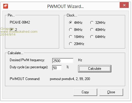

The PICAXE programming editor has a nice tool for this kind of thing:
PICAXE/Wizzards/pwmout
Plop your wanted frequency in there as Hz, click the calculate button, and that should generate the line of code you need.
The MicroMite PWM command is easier, I grant you....Edited by Grogster 2014-09-15
