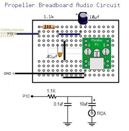

Neato ! ..... I'm experimenting with PWM music also .
Today I was able to add COM1 for percussion !
Do you use any external circuitry ?
I would guess not if you want it to run on a phone.
I think maybe MIDI can be used though ?

I'm running it on an audio circuit that looks like this..
Then into a set PC speakers..
