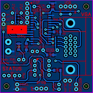

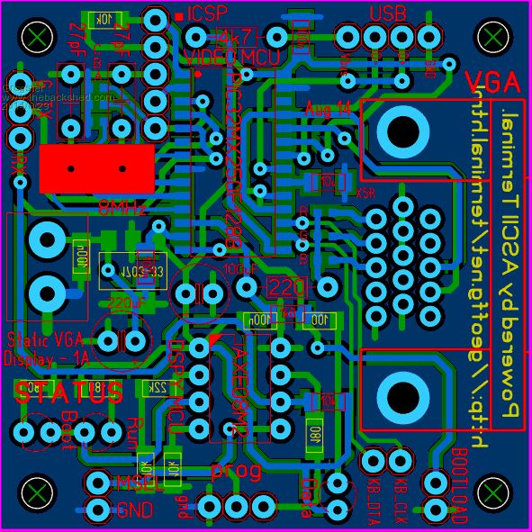

I have developed a board using the VT100 and a PICAXE 08M2 chip.
The PIC32 handles the VT100 side of things, and the PICAXE chip basically just acts as a serial memory of sorts, allowing you to setup a screen(using all the VT100 codes etc), which is then sent to the VT100 PIC32 chip.
The idea being for a pre-programmed VGA display screen for certain applications. I developed this, as I needed a specific screen to show on the VGA when my main system was in remote-access mode via the WAN. When this is requested, an electronic KVM switch is tripped by the main system, which then switches to the display message shown by this unit. Once remote-access is completed, the system reverts to the standard VGA supplied by the MaxiMite based system.
Bench-testing is working great. Not sure if this can be useful for others or if it is really more specific to MY needs, but there you go.
Board is 50mm square, including the VGA socket, baud-rate pads, colour select pads, PICAXE 08M2 message store, LED's etc. In my case, I selected RED as the colour for the VT100 used in this way, as red is often used to indicate something important or something needing attention etc. Using iTead Studio, you can get 10 of these boards for only US$9.90
Here is a quick photo:
EDIT: This is still a work in progress. Although the test version works fine on the breadboard, I have yet to actually get these PCB's made - I should clarify that point...

The main system, running on a colour MaxiMite is also routed through the two port KVM switch. The KMV switch is opened up, and wires run from the button on the top(which selects which VGA/KB/M are connected) back to a relay on the main board, so that the main system can switch the VGA to the "Remote administration mode" message controlled by the board above, and this also has the effect of disconnecting the KB from the MaxiMite(via the same KVM switch), so no-one on site can use the KB to upset what I am trying to do remotely. In the case of the KB, it is really more of an isolation switch, more then anything else.
Some of you may well be wondering why I used a PICAXE, and not the fabulous new Micromite chip.
The reason was PCB space and available stock. The 08M2 is a better fit then another 28-pin SOIC, and I still have 10 or so 08M2 chips in DIL format, so that was why I did it that way. The 08M2 can also run at 3v3, meaning I can directly connect the 08M2 and the VT100 PIC32 directly without any level correction or additional resistors. The 08M2 has 2KB of memory, which is plenty for lots of screen setup strings.
This 50mm module can also be used like the normal VT100 unit, if you don't install the PICAXE chip. The three-way header at the top left is are the standard TXD/RXD/GND connections to the VT100, albeit with no allowance for >3v3 input. There is also a header for USB, so that updating the firmware via USB is also possible, albeit with a slightly customized cable. I am looking at swapping that header for a mini-USB connector, once I find some...

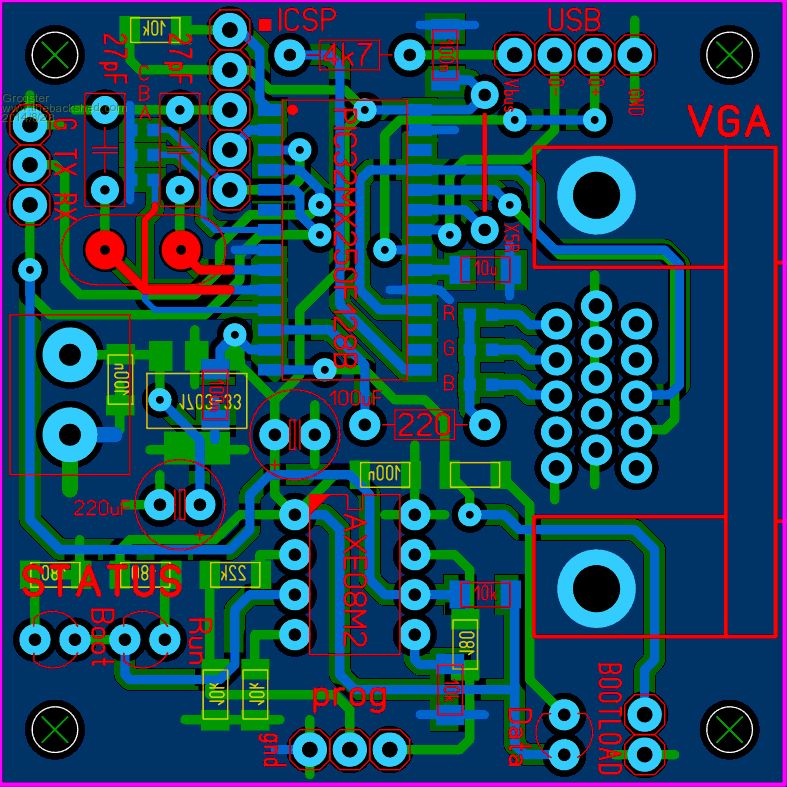

Posts: 10108
Posted: 09:06pm 28 Aug 2014
Here is updated image:
This PCB now contains keyboard data and clock pins, although I just could not find out how to squeeze in the two pull-up resistors + 5v supply for the KB, so these are just the two main pins. Using a KB would be easy enough, with the addition of a 5v supply and resistors across the CLK and DTA lines back to the module - real estate is getting pretty scarce on this board now!
Board also now has provision for multiple messages using a string of buttons on an ADC pin of the PICAXE - you could program several messages into the PICAXE, and select the one you wanted with buttons. Currently no way to select colour - it will have to remain fixed. With a bigger PCB, we could squeeze in the 4066 idea of Rob's, but not on this board!

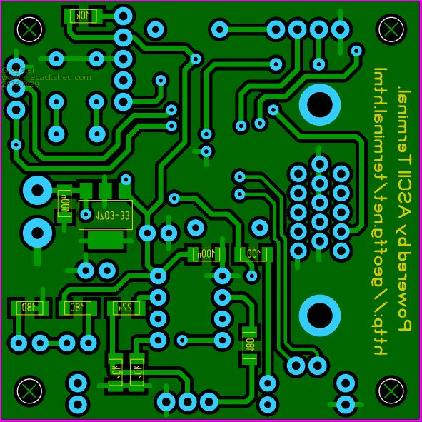

Posts: 2984
Posted: 09:33pm 28 Aug 2014
Groggy,
You can always mount standard 1/4w resistors vertically, that way the legs can be spread what ever distance is needed to make a connection, ie. one res can have 0.1" spacing and another could be 0.2" if you cant space closer..
Can you post a pic of the bottom layer to see what the tracking looks like in that area?

Posts: 10108
Posted: 10:25pm 28 Aug 2014
@ Mick: Here is the C2 layer and it's overlay.
Please note that in this board, BOTH the top and bottom ground-planes are at ground potential. The top copper layer GP is not at 3v3, as might be expected with a double-sided GP board.

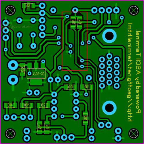

Posts: 2984
Posted: 01:05am 29 Aug 2014
Grogster,
You can do some minor alterations and get the pullups for the keyboard on.
See this mockup.. just a quick photoshop shove job.
Posts: 10108
Posted: 01:17am 29 Aug 2014
Whose a clever boy, then? (rhetorical!)
VERY well spotted.
I will add this to the layout.
EDIT: This will ONLY work, if USB is connected, as you are tapping into the +5v Vbus of the USB connector. However, I think I can rework this idea. Edited by Grogster 2014-08-30

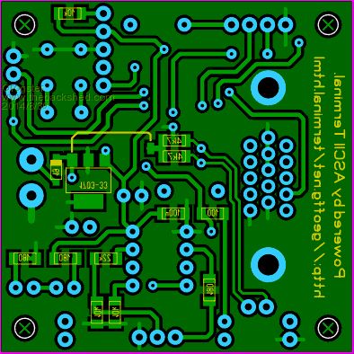

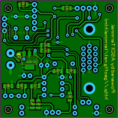

Posts: 2984
Posted: 01:21am 29 Aug 2014
Grogster,
Now would you like me to add a Triode or Pentode Valve for you?
One thing I have learned by doing PCBs is that no matter how full your layout is you can always squeeze something else in.
