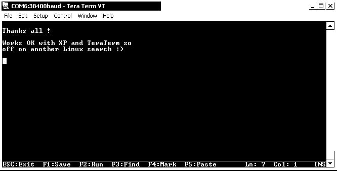

hitsware
Joined: 23/11/2012
Posts: 535
Posted: 12:10pm 27 Aug 2014
Posted: 03:44pm 27 Aug 2014
