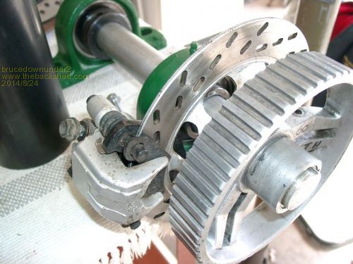

Anyhow, lastly, here's a pic of what I thought I might do some years back..
Still have plenty of this stuff ,,,so may fiddle a bit more.
Thanks for you guys ,but i really don't think you are into what i wanted.

That is not to say we are not interested - I am!
Going on what Glenn has posted in the previous page, perhaps your bike brake idea really is the best - those brakes are designed to be able to stop a lot of moving mass and energy, so....
Where there is a will, there is a way!

Thanks for your interest, thats a motorcycle disc brake and caliper in the Pic.

Yes, I for one, am interested in this idea, cos I also am a backshed mechanic, and love tinkering with my cars at the weekends, when I am not doing electronic kinds of things!
I would be interested to hear Glenn's thoughts on the bike brake concept, cos this would be able to exert a lot of stopping force, so one would THINK that this would be sufficient to slow or stop an prop which was approaching over-speed...
Even considering the figures he mentioned.
False logic perhaps?

I think provided the brake is big enough to pull up the turbine, and we are talking several horsepower, and locks it down so its not slipping and cooking the brake pads, then it could work.
Ideally, the "control" would measure wind speed, and once a certain level is reached for a preset time, would go into brake mode until the wind speeds have subsided, for another preset time. You want to avoid false triggering, like if a little willy willy went past the tower, and you want to make sure the storm winds have passed before letting the turbine spin up again.
Also need to consider how to activate the brake mechanism. Going to need a few kg of force, so a geared motor?
Would be a fun project. The automatic tail furling system used on small wind mills is the simplest, with only one moving part, but bit of a black art to get it working right.
