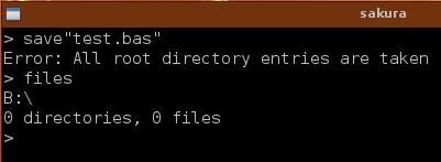

When trying to SAVE:
1) Started getting intermittent 'SD card is write protected'
2) With ColorMaxiMite powered, pulled and reinserted SD card
( seemed to wipe all files )
3) Now see above pic ^
4) SD ruined ? ..... MaxiMite ruined ? .... Missing something simple ?

1) Read SD direct with SD to USB adaptor .... Files seemed intact
2) Reloaded MMBasic hexfile ...... All is well !

It may have been a 'final straw' in my episode, but not the whole problem at all.
My first symtom was intermittent 'SD card write protected' when I'd try to save.
I couldn't find any referance to that in the manual. It happened more and more
until I couldn't save at all. After (in desperation) I pulled the card (with power
(not thinking straight)) came :
Anyways after reflashing the PIC everything's hunky dory ....
Begs the question : Things not to do to corrupt your chip ?
