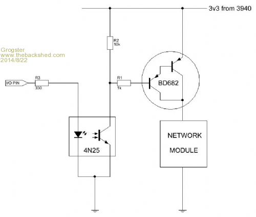

My first idea was this:
This WOULD work, but my concern is voltage-drop as mentioned above. Not really much of a problem if the network module had a greater voltage tolerance, but it does not, from what I can see in the datasheet - it is 3v3 - that's it.
So, using the above diagram, I'd expect a 0.6v voltage-drop across the BD682, leaving 2.7v on the module, and that would be below the specified 3v3.

How about simply switching the Gnd line with a MOSFET driven by the I/O pin. That will work ok.
Use something like an NTR4170N MOSFET (SMD) - then no more components apart from the MOSFET.

Using the transistor to switch the gnd line instead of the power wont make any difference to swtching the 3v3 as the voltage drop across the transistor will still be the same and reduce the voltage across the power and gnd of your module.

EDIT: @ WW - Yes, I think you are onto something with the MOSFET idea. I have looked at the schematic on page 48 of June SC, and can see how they are doing it, so think this is probably the best idea. From what I can remember, once the gate voltage on the FET is present, the Source-to-Drain resistance is very nearly zero ohms, so there should not be a 0.6v drop when using a FET over a BJT - correct?Edited by Grogster 2014-08-24

  Grogster said   From what I can remember, once the gate voltage on the FET is present, the Source-to-Drain resistance is very nearly zero ohms, so there should not be a 0.6v drop when using a FET over a BJT - correct?
Correct - 'On' resistance will be in region of 50mOhm (milli - not Mega!), so applying Ohm's law implies near zero voltage drop.

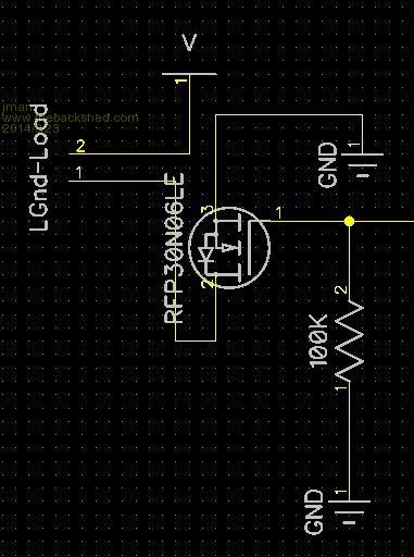

I use this method . This a logic FET a big large for your application
but you get the idea
Jman

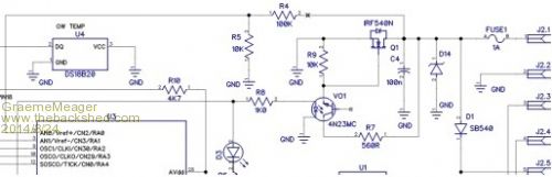

Graeme, I have successfully used an opto and mosfet to regulate solar charging in one of my projects:
2014-08-24_030111_solarshutdown.zip
The mosfet has a switch resistance of less than 0.4 ohm so I can short circuit the solar panel without having any heat issues. Maybe you could do something similar.
The solar voltage is measured with the 10K/100K resistors (R4,R5) but I activate the shutdown by monitoring the SLA battery volts on the other side of D1 in a similar fashion. The mosfet (wrongly represented with an inbuilt diode) is held off with R9 until the opto is activated. D12 is a safety measure just in case the software stalls.
