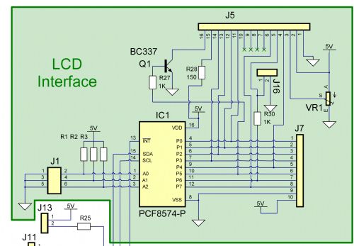

Here is the schematic for the LCD module
EDIT **** J5 is the LCD Module.

When you say D0-D3 I assume you mean LCD D4 to D7 (as 4 bit mode use the high order bits..
The only correction to the above is Backlight is on P5 not P6.
A full list is as follows:
P0 = DB4
P1 = DB5
P2 = DB6
P3 = DB7
P4 = RS
P5 = BackLight
P6 = RW (NO RW control so RW linked to GND)
P7 = EN
A modified circuit of the LCD interface is here:
2014-08-20_021053_LCD_Circuit.zip

LCDI2C_Init I2CAddr,NibPos,RSBitNo,ENBitNo,BLBitNo
LCDI2C_Init &H20,0,4,7,5 looks correct to me
P0~P3 -> DB4~DB7 -> 11~14
P4 -> RS -> 4
P7 -> EN -> 6
P5 -> BL -> 15 via Q1
0V -> RW -> 5
