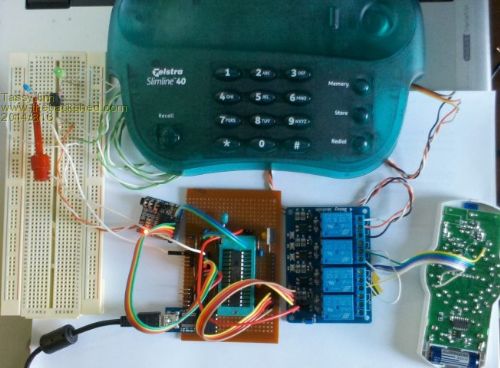

Since our local favorite coffee shop closed, we have been having a lot more coffee at home.
The problem was, the coffee machine needs 20-30 minutes to warm up to give the best coffee and we really want the coffee fix as soon as we get home.
What I needed was a means of turning the machine on 30 minutes before we get home.
Easily done with a maximite.
I decided to use the phone to call home.
My first thought was a microphone attached to the answering machine and this would be my preferred method if I only had one phone line.
Fortunately, I have 2 VOIP phone lines and one never got any use.
I decided to 'butcher' a spare phone.
The phone is old enough to use large (not SMD) components so attacking it was easy.
The output from the ring IC is a 30V square wave driving a piezo transducer. This was connected to an opto-isolator to trigger the micromite.
The audio is sent to a 8870 DTMF decoder module. This outputs 4 bits of data and a 'data available' signal.
The micromite drives a few relays, one to 'pick up' the phone when a ring is detected and 2 to drive the power point remote control.
The coffee machine power point is controlled by a Kambrook' controller but any brand that has separate buttons for ON and OFF will do.
The photo shows
The phone
Breadboard with the opto-isolator and capacitors to isolate the phone from the ground of the micromite.
DTMF module
Micromite
Relay module for controlling the Kambrook controller and phone 'off hook'
Lastly, the transmitter for the Kambrook controller.

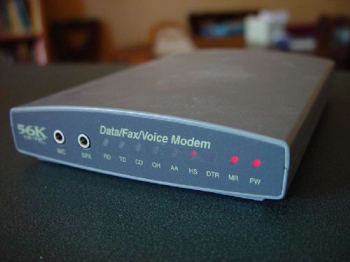

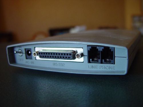

for the hobbyist, the safest approach is to make use of two easily and cheaply obtained items:
1. an external serial dialup modem that supports a headset - that is, has a microphone and earphone socket on the front. these can often be had very cheap second hand. via the serial port the modem: provides ring indicator (RI) and an ability to pickup the line, can generate DTMF tones, and hangup. via the earphone socket: isolated audio can be fed into a DTMF decoder, and recorded messages played to the calling person/device.
one modem popular in new zealand 15 years ago was this one:

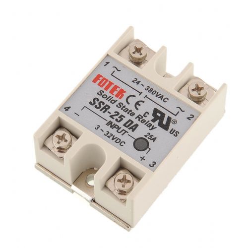

2. a solid-state relay, such as this one:
http://www.ebay.com/itm/221522739619
solid-state relays are quite magic, able to be driven directly by an output pin from a processor, while keeping mains wiring safely isolated and out of the way. i've used them in a number of places to provide a simple solution. they do drop 0.6v on the AC side, so with a 10A load will dissipate 6w.
your SSR can fit into a small-sized jiffy box with a mains lead passing in and out at one end, and a socket for the 3-30v control input at the other end. once the cover of the box is in place, it is all totally isolated and quite safe.
using these two device (SSR and serial modem) you can knock yourself out in the knowledge that no matter what, you will continue to be able to make and receive phone calls, unhindered by the inconvenience of either burnt phone wiring or death.

wrt the use of a modem, i was thinking more of the transformer and optocoupler isolation provided by the modem, ensuring that your gear doesn't present the outside phone line with any unexpected loading to ground. while modems need to be strictly isolated to function in all installations, a standard corded phone often does not - it can provide no isolation and just float.
as to what happens inside a pap2t or similar sip/voip adapter, it is anybody's guess. one or other side of the internal line may (or may not) be grounded, and 50v ac ring current may be generated relative to who-knows-what. but if you are aware of all this, it is not so much of an issue: a relay, optocoupler,600:600 ohm transformer and a few passives may replace a modem or phone.
my advice was directed towards those who want to experiment but who are not so technically savvy. with an SSR and modem in use, one is as safe as can be hoped (bar lightening strikes).
