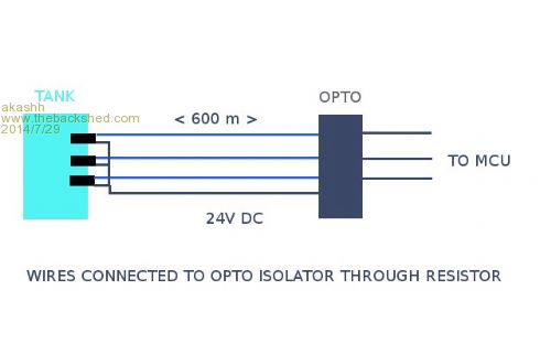

Hi,
Just for clarification I've included a diagram of the cabling:
So, I would need to figure out how to get a ground wire (I only have 24V, which is looped back through the float switch to the opto)...

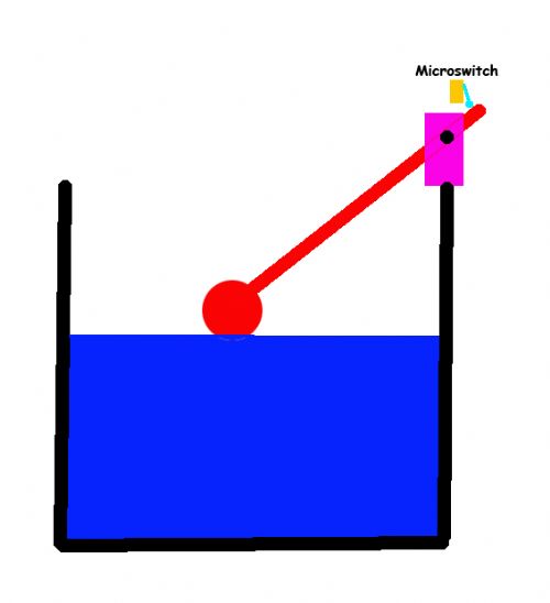

I would do something like this:
The Pivot and microswitch are OUT of the tank and the long part of the arm is in the tank.. Use the most appropriate sized ball for the job.. BASKETBALL for huge tanks (held on by a wire cage) or pingpong ball if only small tanks.
You can add a threaded bolt onto the top of the gimble to give your self some adjustment.
Good Luck
