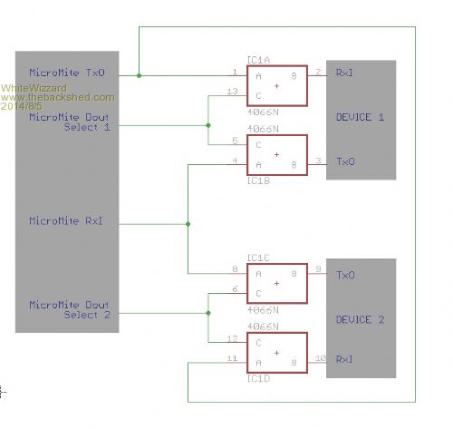

@ WW: I have a need for something similar myself now, and rather then use a mechanical switch or relay, I like the CMOS idea. Could you please post your schematic of how you wired the 4066 into the MM, so I can get an idea of how to plagiarize your idea?

@Grogs
Hope this gives the general idea . . .
If you are not familiar with the 4066, it is basically four SPST switches in a 14pin package. Each switch has a control signal 'C' that opens or closes the switch depending on logic level applied to 'C'. The switch is between 'A' and 'B'. There is no specific input or output to a switch so A and B connections can be interchanged to make any PCB layout easier.
The above circuit uses two MicroMite I/O pins (set to Dout) to select either Device 1 or Device 2 to be connected to the MicroMite COM port. Ensure your software does NOT select both Devices simultaneously otherwise potential damage may occur to your Devices.
Alternatively (if you only have one spare MicroMite I/O pin) use just the one I/O pin connected to one half of the 4066 (i.e. pins 13 & 5) with an invertor to the other half of the 4066 (pins 6 & 12).
Let me know if you need more info . . . .
WW

Lovely, thanks buddy.
I downloaded a PDF for a 4066, but was trying to work out how the switches worked.
This was the paragraph that lit the light-bulb in my head - thanks. I have not used 4066's before, so it was a new chip to me.
