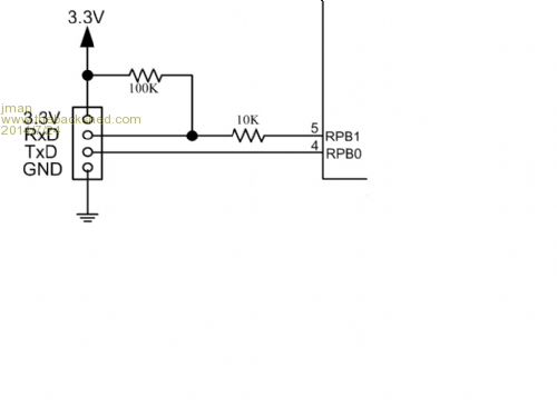

Where does MicroMite (and which pins?) hookup ?
BobD
Joined: 07/12/2011
Posts: 935
Posted: 06:38pm 23 Jul 2014
  hitsware said   Where does MicroMite (and which pins?) hookup ? [/quote]
They hook to CON1 at the bottom left corner of the image.Edited by BobD 2014-07-25
jman
Joined: 12/06/2011
Posts: 711
Here
Jman

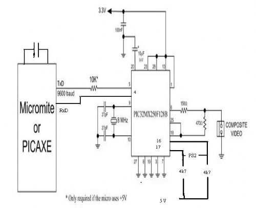

Posted: 04:51am 24 Jul 2014
essentially: ?
Posts: 2998
Posted: 09:15am 24 Jul 2014
Looks ok apart from cap on pin 20. IF you use a tant then polarity is +ve to pin 20 and -ve to gnd. OR use a ceramic multilayer which are cheaper and better (longer life).

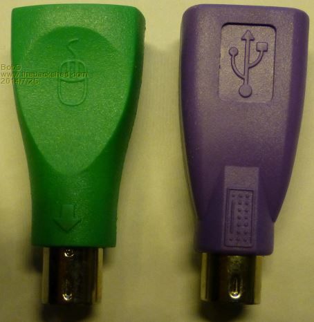

BobD
Joined: 07/12/2011
Posts: 935
Posted: 03:32pm 24 Jul 2014
If you are going to use a 5 volt wall wart to supply the keyboard then you should buy one that has a regulated 5 volts. Unregulated wall warts under light load may put out much more than their nominal voltage. This could lead to component failure.
