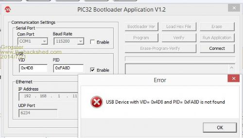

OK, removed the BAUD jumpers, which I had installed for 38k4 by default, and then I was able to program the device - it obviously does not like certain things on it's I/O pins when programming, but now that I had the FW in there, I realised it was the old one, so tried to upgrade to 1.2 using the download and the procedure in the instructions, but when I put in a PID of 0xFA8D and click connect, the software just spits back that it can't find any device with that address.....
Instructions went fine until step 9 - as soon as I click CONNECT, it just says it ain't there to be had.

Are you using a Pickit3 to load V1.2? That is not allowed. We just a big thread about that. The original goes in via a Pickit and that includes a bootloader. The updates must follow the procedure in the ZIP.
edit: Retract that, I have it wrong what you were doing. It must be the sauce I had with dinner. I can't see straight.Edited by BobD 2014-07-22

  Grogster said   OK, removed the BAUD jumpers, which I had installed for 38k4 by default, and then I was able to program the device - it obviously does not like certain things on it's I/O pins when programming. . .
You MUST remove Baud rate Jumper C when programming v1.0 ASCII Terminal Firmware. If not then you are grounding the PClk signal from the PicKit 3 and hence programming won't work.

Yes, that was also a mistake of mine - live and learn!
With the jumpers in place for 38k4, the PK3 would have nothing to do with the chip no matter what. Once I removed the jumpers, I WAS able to program in the 1.2 FW using PK3, but only then discovered that this was the wrong way to do it - I guess I have just got TOO used to programming MicroMite chips, where you just flash the virgin chip directly with the PK3, so just went along that road without really thinking much more about it....
