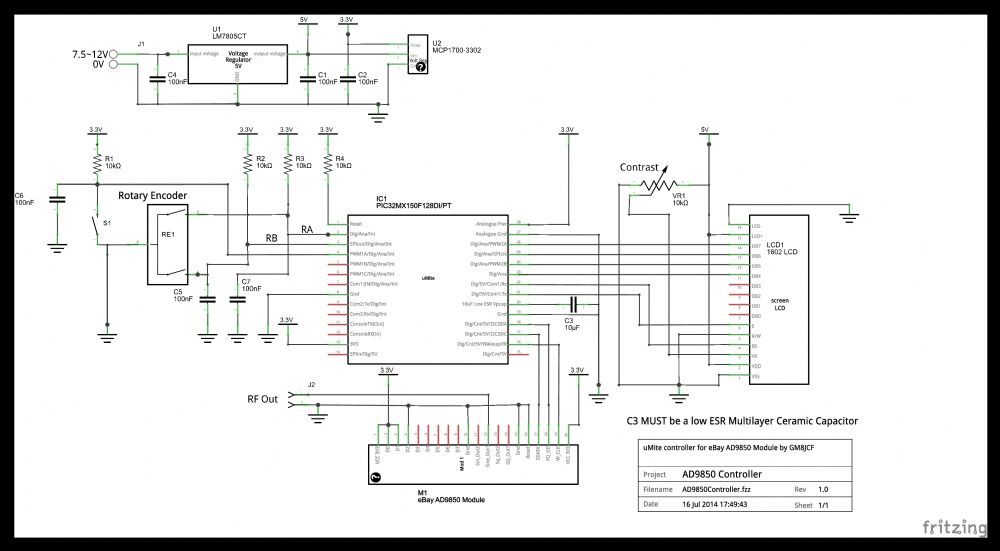

Hi
Thanks to feedback from @boss, and comments from several people, I've amended the AD9850Controller source code so that it runs more quickly than previous versions.
Version 11 changes from Version 9
- Include tuning step sizes 10,000, 100,000, 1,000,000 Hz
- Implement Native SINGLE precision for step-sizes of 100Hz or greater
else use use BCD library
- Optimised DDS write SUBS
- Changed ISR's to SUB/END SUB
- Added Sub StepChange to respond to Push Switch
- Updates to LCD are now done only every 100mS, see SETTICK 100, DispFreq,1
Known Problems
- If the Step size is set greater than the current frequency and the encoder is
rotated ANT-Clockwise, "strange" operating frequency results, but rotating
Clockwise so that the operating frequency is GT than step-size returns the
op freq to correct values.
TTD
- Update the BCD arith routines to process quintets of digits at a time
- Fix the Step size vs Op Frequency problem
Please let me know how this release works for you.
73
Peter

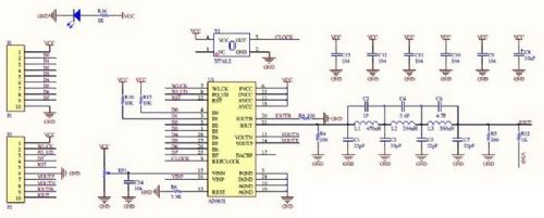

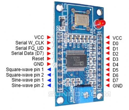

Here are the
1) Schematic of my set-up (my first time with Fritzing, so it doesn't look very pretty)
2) Schematic of the eBay module
3) Picture of the eBay module
Hope these help.
73
Peter

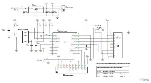

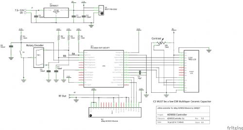

Here's a more readable (I think) version of the schematic.
73
Peter

Posted: 01:36pm 16 Jul 2014
Sorry, posting JPG's doesn't seem too good !
So here's the picture as a GIF
If anybody wants the hires PDF or .FZZ just PM me with your email address and I'll send it directly to you.
73
Peter
