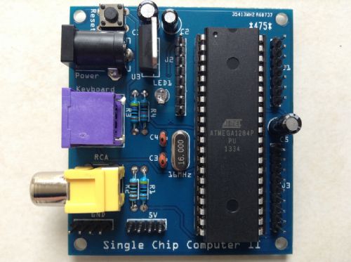

Interesting Basic Computer built around and 8-bit device and completely easy to built DIP package.
Wonder if this could be done with a PIC18F and Great Cow Basic.
More Info Here

Posted: 02:16am 14 Jul 2014
If PIC18F has to be involved, it must be a 64MHz capable device 'cause it will match the ATmega1284P speed at 16MHz. P18F46K22 is a 40 pin device with 64Kb FLASH (do we have one with 128Kb?) and 4KB RAM (that ATmega has 16Kb RAM - a monster). Good for Dk-Basic.
The SPI, I2C and Analog pins on ATmega are available on those free ports...
I think it is possible if the TV-out thing can be implemented.
Anyway, I guess Microchip complicate too much the peripheral thing... too many features are battling for the available pins...
____________
It will be much more useful if it comes designed for Gameduino 2 (and then, things are simplifying much more as you can use Firewing BASIC). Worth a try?Edited by vasi 2014-07-15

Posted: 02:40am 14 Jul 2014
Oops. in the actual implementation, around 8Kb of RAM are used for Video frame buffer. A gameduino 2 (or even one from Olimex) is a requirement. And with Dk-Basic (bytecode compilation) you can make a better 8bit computer. Still, too less RAM on PIC18F!
From the comments, there is a tip regarding Video:
[quote]Just a tip from someone who built this before: try using SPI2X for serializing the video output, or alternately use a 74165 PISO. You'll get much better video resolution, definitely worth it. [/quote]Edited by vasi 2014-07-15

Posted: 03:29am 14 Jul 2014
PIC18F67K22 has 128k and 3.8k RAM but its a 64 pin part so you lose the DIP package.
I didn't see any reference for the Gameduino requirement.

Posted: 03:41am 14 Jul 2014
  elproducts said  ...
It becomes a requirement if you want to do your own using a PIC18F as you don't have a 8Kb of RAM for the video frame buffer. On other words, you give up on generating video signal using the microcontroller and you have more features for the BASIC interpreter. I thought my comments where clear enough... I have to work more on my English. It is everything there, in your link...
