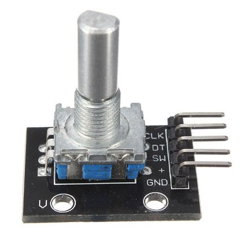

Hi
The KY040 Rotary Encoder module is widely available on eBay for less than US$2.00 inc P&P to UK, See Link
Anyway, here's some demonstrator software to show how to wire the KY040 up to a uMite and use it. The code is also available on MMReference.com Thanks David.
Hopefully this code will help more people to use Rotary Encoders with their uMites.
73
Peter
' Rotary Encoder (KY040) Demonstrator
' MMBasic 4.5 or newer.
' (c) Peter Carnegie 2014
' The KY040 module contains a rotary encoder together with a push-switch on a small
' PCB with 5 Connections. The KY040 was developed for Arduino, but of course us uMite
' folk can use it as well, and the KY040 is incredibly cheap, US$2.0 inc P&P, just
' search eBay for KY040.
' Wiring it up
' KY040 Micromite
' CLK 2 ---> 0.1uF ---> Ov
' DT 3 ---> 0.1uF ---> Ov
' SW 4 ---> 0.1uF ---> Ov
' + 3V3
' Gnd 0V
' NB
' 1) It is VERY important to decouple the DT,CLK & SW pins to 0V
' using 0.1uF at the uMite end of the link wire.
' If you don't decouple these signals, severe contact bounce will be evident,
' eg one click will generate a dozen or more increment/decrements.
' 2) The KY040 module has on-board pullup resistors. You must supply 3V3 or less
' to the + pin of the KY040 module
' 3) This s/w works fine with just a standalone rotary encoder, but you will need
' to supply your own 10K pullups to 3V3. For a standalone encoder RA=CLK, RB=DT, & SW=SW
' When this software runs, each CLOCKwise step of the rotary encoder will result
' in an increase of the variable DisplayValue which will be printed to the Console.
' Each ANTI-clockwise step of the rotary encoder will result in a decrease of the
' variable DisplayValue which will be printed to the Console.
' Pushing the push-switch will clear the variable DisplayValue to 0.
' This demonstration s/w is Interrupt based for maximum responsiveness.
' This software improves on the snippet listed
' in the Micromite User Manual in that the count, DisplayValue
' increases/decreases more smoothly/accurately.

Hi Peter,
I bought the same encoder module on e-Bay, so thank you for the description and the code. I'm using right now an optical encoder (Bourns ENA1P-028) purchased a couple of months ago on eBay for a bargain price(~$6 + shipping). Although optical encoders are designed for 5V they work with 3.3V as well.

G8JCF
Joined: 15/05/2014
Posts: 676
Posted: 05:09am 13 Jul 2014
@boss
I'm assuming that you are referring to the AD9850Controller software I published on TBS ?
1) I can't find line 218 which says CurFreq$(1)=CurFreq2Asc$()
2) Are U using MMEdit with Auto-Crunch and "Delete Blank Line" set ON ? Could you please make sure that MMEdit is configured with "Delete Blank Lines" set to OFF so that my source line numbers and your source line numbers line up.
3) I think your line 218 may be referring to my source line 420, in which case try changing line 418 LOCAL CurFreq$(1) Length 8 to say LOCAL CurFreq$(1) Length 10
4) The best thing to do would be implement "gearing" in the Rotary Encoder handling, Try this replacement ISR for RINT.
'Interrupt Routine
'Here when the Rotary encoder moves
Sub RInt
Local Ratio
Local Gearing
Gearing=10
'Do gearing - change Gearing to suit your tastes
Ratio=Ratio+1
if Ratio>Gearing then
Ratio=0
IF PIN(RB)=1 THEN
'Clockwise rotation
Value=Value+1
End If
ELSE
'Anti-Clockwise rotation
Value=Value-1
END IF
End Sub
Please let us all know how it goes.

G8JCF
Joined: 15/05/2014
Posts: 676
Posted: 06:05am 13 Jul 2014
@boss
I pasted your source into MMEdit, but line 218 says Cy=0, and also the step sizes in the code you posted seem to be the same as the original, ie
'Array of Possible Step Sizes in Hz
Dim StepHz(4)
StepHz(0)=1
StepHz(1)=10
StepHz(2)=100
StepHz(3)=1000
If you need larger step sizes then proceed as follows
1) Increase the size of the StepHz array, eg
Dim StepHz(6)
StepHz(0)=1
StepHz(1)=10
StepHz(2)=100
StepHz(3)=1000
StepHz(4)=10000
StepHZ(5)=100000
2) Increase the number of Step Tuning Words, eg
'What to Add/Subtract from the Scaled tuning Word
'for each Encoder Up/Down
Dim StepTWord$(6) Length 24
'These TuningWord sizes were calculated using Double precision arithmetic
'in VB6, using 2^32/125.0
StepTWord$(0)="34359738" '1Hz 34359738.368
StepTWord$(1)="343597384" '10Hz 343597383.68
StepTWord$(2)="3435973837" '100Hz 3435973836.8
StepTWord$(3)="34359738368" '1000Hz 34359738368
StepTWord$(4)="343597383680" '10000Hz 343597383680
StepTWord$(5)="3435973836800" '100000Hz 3435973836800
3) In SUB StepChange make the modification to accommodate the extra step sizes, eg
Sub StepChange
CurStepIndex=CurStepIndex+1
'Roll round CurStepIndex if greater than 5
CurStepIndex=CurStepIndex Mod 6
'Load the CurStepTW with the Step in TW
LoadBCD CurStepTW(0),StepTWord$(CurStepIndex)
'Could display something on the LCD to indicate New Step in force
'eg Underline digit.
End Sub
$) Also you could change - simply for neatness
line 98 SETPIN RSW, INTL, Roll
TO
Line 98 SETPIN RSW, INTL, StepChange
and delete
Roll:
StepCHANGE
IRETURN
Did U try the Gearing/Ratio suggestion in my last post ?
That should do it, the frequency should never be longer than 8 digits when using an AD9850, the highest frequency the AD9850 can generate with a 125 MHz clock is 125/2=62.5 MHz clock, and with these eBay modules anything above 30 MHz is not really worth using.
