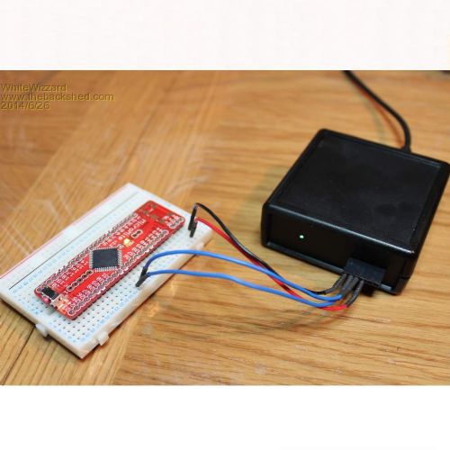

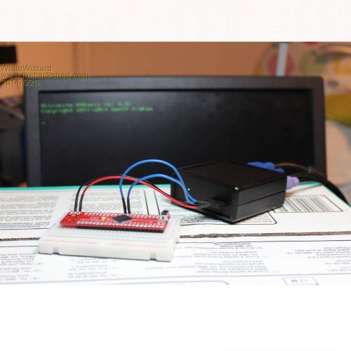

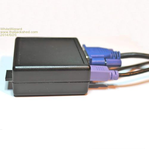

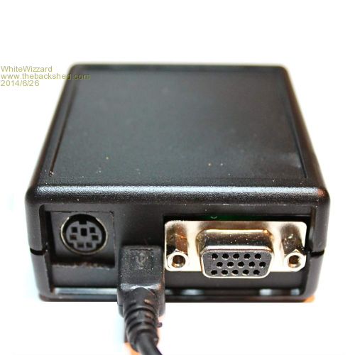

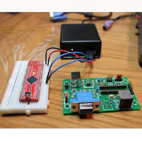

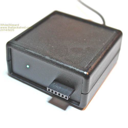

Regarding parts for the ASCII Terminal, I will be selling component kits hopefully within the next week (waiting volume of parts from various global suppliers). This will include everything APART from the PCB. The reason for this is . . .
I am about to release the TermMite-VT100 which is a more compact version than that published in Part 3 of the excellent Silicon Chip series. The TermMite-VT100 is housed in a nice little ABS enclosure, and measures just 68mm x 68mm x 28mm.
I have not yet finalised the PCB layout and I have a couple of nice extras up my sleeve (ZIF socket for a 28-pin MicroMite). For a quick look at an early prototype please take a look at the following photos. These photos are of an early prototype but it should give you a rough idea of what the final product will look like.
Any questions then please contact me . . . .
WW
viscomjim
Joined: 08/01/2014
Posts: 925
Posted: 09:38am 26 Jun 2014
WW, very cool indeed. I need to play with this!!!!
Posts: 10114
Posted: 01:02pm 26 Jun 2014
Agreed - very sexy little unit there, WW.

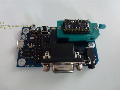

Well, if not in rush about making Geoff's terminal, anyone might have a look at my option as well (due for release soon). I have been working on this since the late 2013 but didn't get to finish it earlier.
The little black thingy in the ZIF socket is my low cost A/V controller - a 16-pin DIP hybrid chip-module.
For anyone interested in the schematics of these (these are the final release revisions):
DTX1-1740P
DEB1-AV
I will have the full documentation of DTX1-1740P ready for the release...
http://rittle.org

Wow..!! Nice Design...
So, you would control the subsystem with SPI commands... Is the SWD connector on the prototype board made for programing new firmware onto the device..? Any info on the control protocol..? Sound input and output... nice... Graphics...?
kiiid
Joined: 11/05/2013
Posts: 671
Posted: 10:53pm 30 Jun 2014
Thanks Zonker.
I am still working on the documentation, but in most general overview - yes, it is controlled by SPI (in fact mSPI, which is simply addressable SPI). From user's point of view it looks just like a memory array in which you write or read from. Pretty simple to control. This will be in the first release. In future there might be some 'commands' to perform some higher level functions. I am always open for input from other users.
The SWD on the dev board is for programming and debug the firmware.
The input - by initial idea it is for handling an analogue keypad so the input filter has low cutoff frequency in the prototypes. In future I might relax it a bit so it will take sound input as well.
The graphics is native EGA - 640x350 in 16 colours. To this model I have a few important extras in store which I won't discuss just yet.
Availability for the first samples - sometime in late July/early August.
