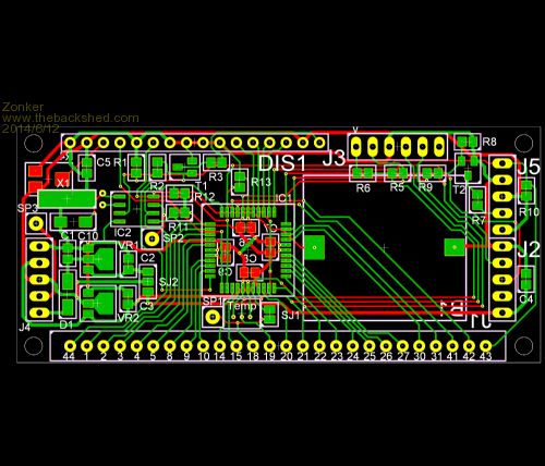

Good evening Gent's...
Well, I think I'm getting to the done'r side of things on this PCB, and wanted to possibly get some feedback from you fine folk before any ordering goes down...
It was produced on the DEX package Big Mick told us about. It is made to fit just behind the 2x16 LCD display, same size, (80x35mm) with matching mounting holes. RTC and Temp IC's are on board, and I was thinking of adding a LTC2631 DAC chip...
If so, I wanted to check with the IIC guy's out there as to properly get the REG addressing correct as to not interfere with the RTC. Also is the question of the REF voltage. Is it ok to use +5 volts for DAC power and REF pin input..? The RTC chip is running off the 3v battery. I'm not sure if the pair can work correctly at the 2 different voltages... Probably not... any feedback would be a big help for the layout...
During the design, we were careful not to use any of the multifunction pins for internal devices. I did manage to have enough room to use the CR2032 (20mm) coin cell with the Harwin socket. It is mountable from either side of the board, so if you back mount it, you have a good amount of topside for an extra IC part... Hence my thinking of the possible DAC chip... Any other ideas..?
Also, will be spinning up a bottom "sea-o-holes" board to go with it and offer it up as package on Phil's website...
Attached is the "info" pack for it...

Z-Cards *44 LCD Prototype Module MCU Pin Usage
PIN PORT PIN USE ON BOARD J1 PIN
01 - RB09 External RTC SDA 2
02 - RC06 External 3
03 - RC07 External 4
04 - RC08 External 5
05 - RC09 External 6
06 - Vss
07 - Vcap
08 - RB10 External 7
09 - RB11 External 8
10 - RB12 External 9
11 - RB13 Internal DISP LED
12 - RA10 Internal DISP RS
13 - RA07 Internal DISP E
14 - RB14 External 10
15 - RB15 External 11
16 - Avss
17 - Avdd
18 - MCLR Asignable 12
19 - RA00 External TEMP DQ 13
20 - RA01 External 14
21 - RB00 External 15
22 - RB01 External 16
23 - RB02 External 17
24 - RB03 External 18
25 - RC00 External 19
26 - RC01 External 20
27 - RC02 External 21
28 - Vdd
29 - Vss
30 - RA02 External 22
31 - RA03 External 23
32 - RA08 Internal IR Tx
33 - RB04 Internal Console Tx
34 - RA04 Internal Console Rx
35 - RA09 Internal DISP D7
36 - RC03 Internal DISP D6
37 - RC04 Internal DISP D5
38 - RC05 Internal DISP D4
39 - Vss
40 - Vdd
41 - RB05 External 24
42 - RB06 External 25
43 - RB07 External IR Rx 26
44 - RB08 External RTC SCL 1
Feedback always welcomed...

Well, I decided to go with a Microchip DAC instead... But again I want to check with the IIC guy's out there... As far as I can tell from the PDF file, the RTC chip uses the address "A2" for write operations, and "A3" for read operations....
The MPC 4725 DAC chip uses a combination of a "device" code (upper 4 bits set to 1100 (C hex)).. the next 2 bits are "hard-set" from the factory when you order the IC, and the last bit is controlled by the A0 pin on the IC...
When I order the part, I was going the get the one with the factory bits set to 00, so the part will have a slave address of C0 or C1 depending on the A0 pin... As far as I can tell, this should not contend with the RCT addresses... Also, the RTC is only read every once in a while, so much of the time, there wouldn't be address conflicts anyway... (I think)...
So, just to be sure, I wanted have somebody check this over and see if my thinking is right... Thanks for any feedback..!!

Frank N. Furter
Joined: 28/05/2012
Posts: 1186
Posted: 08:13pm 15 Jun 2014
Hi Zonker,
the RTC uses the 7bit address h51 (hA2 for write and hA3 for read operations).
The MPC4725 uses the 7bit address h60 or h61, independent from A0 (with factory setted A2=0 and A1=0).
The LTX2631-Z uses h10, h11, h12, h13, h20, h21, h22, h23 or h30 independent from CA1 and CA0.
There should be no address conflict between any of these chips...
Frank

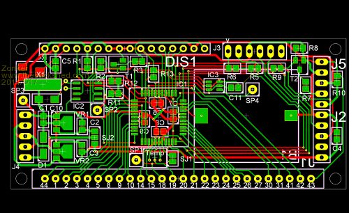

Good evening Gent's... Dumbass here....
It seems that I posted the wrong DAC file, as I have the board setup for the MCP4725 DAC from Microchip... The PDF is to big to load here but we ended up ordering some test parts anyway...
@Frank... Thanks for the info fine Sir... Would it be ok if you take a look at the "correct" data..? This IC seems to have a device code of 7 bits... The upper 4 are set to "C", the next two are set when you order the part, (we chose "00") and the last bit is controlled by the A0 pin... So, if I ground the A0 pin, we get "1100000" as the device code... Hope this works OK...
I know "zip" about IIC stuff... Could you give some simple "init" code for this guy..? just want to write some board test code when it ships out to people... I want the board to boot-up, announce itself on the LCD display, and test the onboard hardware for it's new user...
I got the DAC onboard... Starting cleanup... Parts sizing test soon...
Here's the info update...
2014-06-17_025156_PIC32-44pin_LCD-Proto-DAC.zip

Posted: 08:12pm 16 Jun 2014
Hi Zonker,
you are right. The address should be h60 (b1100000) with grounded A0, I've loaded the correct datasheet yesterday...
I haven't any code for this device but I found BASCOM code for it:
BASCOM Code
and here is the link for the translated site:
BASCOM Code translated
(I hope the link works)
Frank
