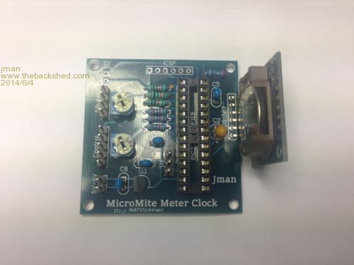

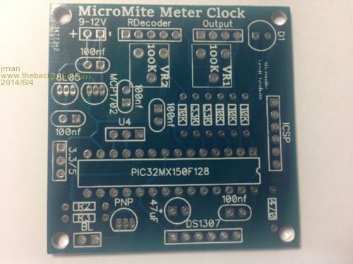

The PCB below is the version without the 5V regulator and PWM backlight
The PCB below is the version with the 5V regulator and PWM backlight
I have attached the circuit diagram, gerbers, meter scales and Micromite source should you wish to make your own.
I have a couple of both types of PCB should anybody want one unfortunately the both contain an error that requires a track to be cut a wire link to be added.
I will do this should anybody want one.

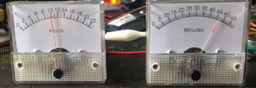

The backlights are diffused LED’s of your colour choice these are fitted to the meters by drilling two appropriately sized holes (3mm or 5mm) at the bottom (two required) of the two meters.
The meter scales were done using MeterBasic from here http://www.tonnesoftware.com/meterbasicdownload2.html

Meter connections are 1-2 Minutes 3-4 Hours

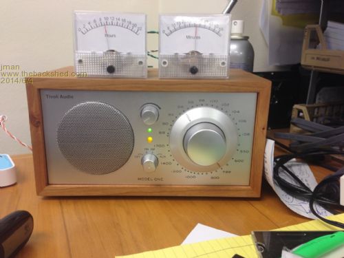

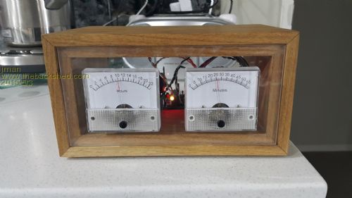

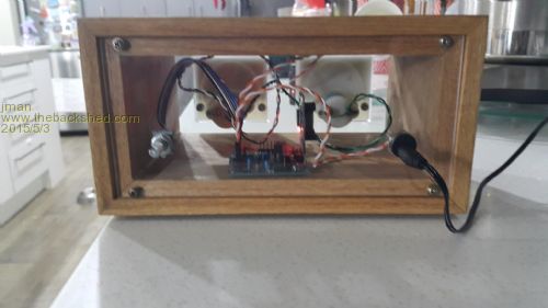

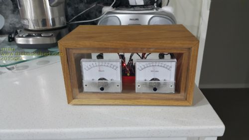

Posted: 03:36pm 02 May 2015
So I finally put in a box that matches my Radio
Jman

Joined: 08/01/2014
Posts: 925
Posted: 01:04am 03 May 2015
Nice work! This has been one of my favorite uMite "projects". The case looks great.
