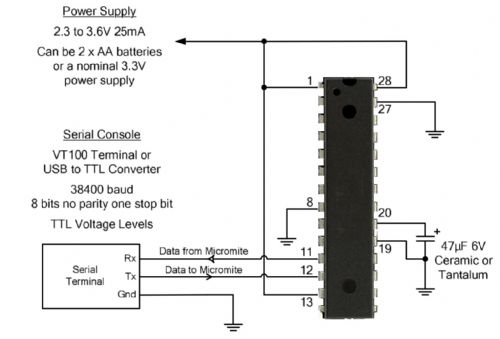

Check that C1 is connected (using a meter), +ve (the side with the line if using a Tantalum) to pin 20 of the pic32 and -ve side to pin 19 of the PIC32.. Also check that there is no short across the capacitor..
Now you may be aware of pin numbering but just to be sure this picture shows the pinout clearly.
