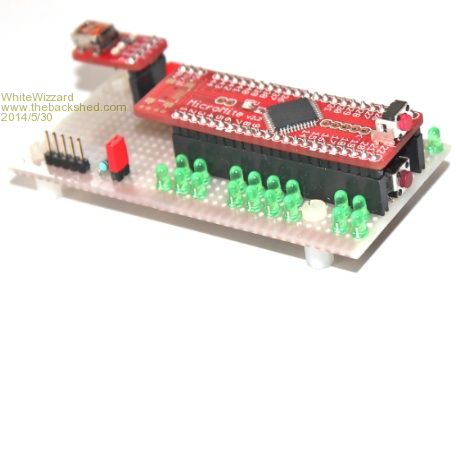

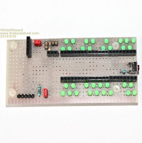

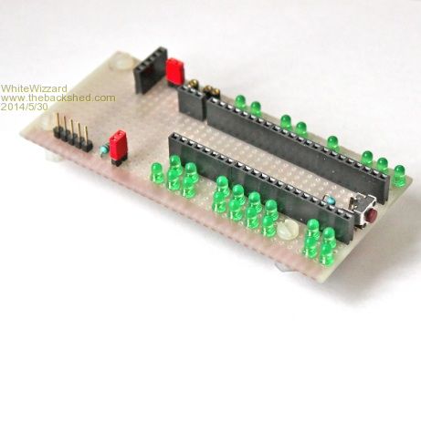

This kind of 'test unit' is invaluable when checking the integrity of a MicroMite Module. I use something similar for testing every 44-pin MicroMite module I despatch. The main purpose is to test connectivity of the SMD PIC pins - it is not for testing a pin's functions (everyone's Beta testing checked this!). I don't see much use other than a test unit which is why I haven't manufactured a PCB. This unit was built on some spare veroboard and only took an hour to create - and I use it every day!

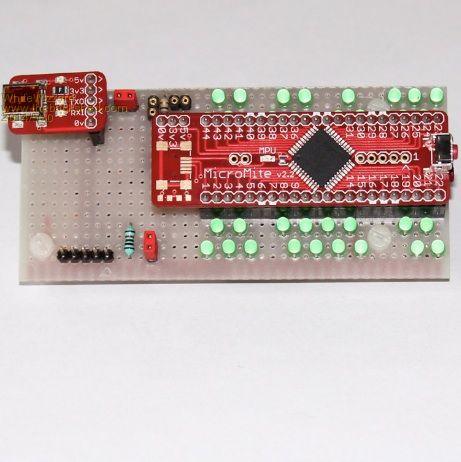

This unit allows me to test a MicroMite Lite (i.e just the PIC + caps on a PCB) or a fully featured MicroMite module. With regards to a MicroMite Lite, various permutations are available: with/without reset switch; with/without ICSP. This is why I have included an onboard ICSP (lower left) and reset button - i.e. in case the Lite under test doesn't have them fitted as options BUT I still test the functionality in case the end-user installs it themselves.
(Note: these are not self-powered LEDs - just reflecting the camera's flash!)
I simply load a test program using MMEdit which pulses each of the 33 pins high, one at a time, with a short delay between each pin (to allow me to see the LED on). I have 'staggered' the LEDs so it is visually obvious if a pin is open-circuit (your brain expects to see a zig-zag pattern - if one pin is not connected then you 'see' it much more clearly than if the LEDs are in a straight row (useful tip!)).
Here I am testing a Lite with no ICSP but it does have a reset switch fitted. You can see the USB Module used to communicate with the MicroMite plugged into the header in top-left of unit. If testing a fully featured MicroMite then no USB module is used.
Test points around the USB module header allow me to check 5v and 3v3 levels.
So in summary - the most valuable tool EVER for checking my MicroMites prior to despatch. I have logic analysers and various MultiMeters but this is so quick and easy to use and does a full check.

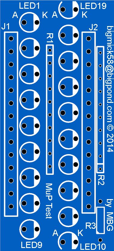

OK I have done a design, of course this really only goes with my MuP boards, you would need to make an adapter to suit the pinout of whatever other flavour of uMite you need to test.
I think I will get a few done (probably ony a dozen or so).. I will get some quotes with details later..
But here is the overlay.
and the Schematic:
2014-06-02_072841_MuP_Test_Schematic.pdf
I will try the "dirty crumby rotten PCBs" that Jman mentioned earlier and see what we can get them down to.
The size is only 22.5mm x 49.5mm so we can get two per 50mmx50mm layout or 8 per 100mmx100mm layout but they would need to be cut (carefully some tracks are close to the edge..

Two things:
1> Is this a double-sided PCB to allow the LEDs (or connectors) being on the 'opposite' side of the board so that all the LEDs can be seen when this PCB is connected to the MuP?
2> J2 pin 10 to ground - is this correct? From memory this is Vcap isn't it? (I am not next to a MuP at the moment to check this myself so just wanted to highlight this as a possible error (apologies if I have remembered this incorrectly)
WW
Posts: 2984
Posted: 10:56pm 01 Jun 2014
Hi Phil, All,
1.
YES! it is a double side board with copper pour both sides (mainly for strength and stability as it it to be plugged in and out many times..
2.
Pin 20 is GND because the MuP header pins were designed so that pin 20 (Vcap+) did NOT come out onto the bus, I thought about putting 5V there but decided on another GND, a solitary 5V pin in the middle of the line up, I felt, was a bit dangerous if anything was misaligned when plugged in..
I had a look at `Dirty Crappy rotten junko PCBs' and to `panelise' every board must be connected via some tracks to each other,
I cant seem to work out how to panelise with AUTOTRAX but I will keep looking..
Will keep you all informed when I have some ideas of costs, maybe only looking at 25 or so, at least initially.. I dont see these being a big seller.
EDIT***
Yes the connections to the MuP, are bottom mounted, and the LEDs, resistor and 2 x resistor packs are top mounted.. Which just reminded me, I made those pads holes a bit smaller visualising that they would be FEMALE only but of course you may have made MuP with Females so you need to be able to put MALEs there. I will fix that before I get any made.
