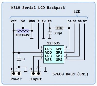

The Diagram shows a PIC12F635, however the code supplied on the link is for PIC12F683. But probably not too hard to port to PIC12F635.

Qualified success.
Upon initialization the display showed several characters of garbage. But accepts characters. It displays "Hello" after the garbage. It will not accept command data.
The scope showed RS not staying high long enough. So the CAP was changed to 1nf and it seems to work OK now.
By looking at the scope, it seems that the cap is being charged by two 5us pulses. With a 330p Cap there is a dip to zero in the middle of the signal on RS.
Increasing the cap to 1nF reduces the dip to an acceptable level. Now there is no garbage, & I can send 0xFE, 0x01 to clear the screen.
This is a Newhaven display with a ST7066U Controller.
Could it be that the loading on the RS pin varies between driver chips?

Thank you for your qualified testings. Yes, I have three 2x16 LCDs which required different timings for initialization.
Exactly your controller!!!. So for me is great to know this (I will include the both capacitors and select them with a jumper).

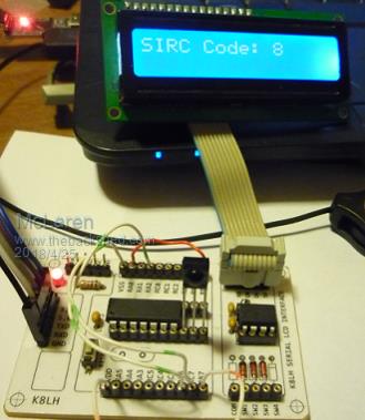

McLaren
Joined: 28/06/2011
Posts: 11
Posted: 01:00pm 25 Apr 2018
I'd love to see pictures of how you guys implemented this little backpack design. I didn't do much with it except to put it on a little 8-14-20 pin development board (picture below).
Cheerful regards, Mike McLaren, K8LH (Michigan, USA)
Edited by McLaren 2018-04-26
