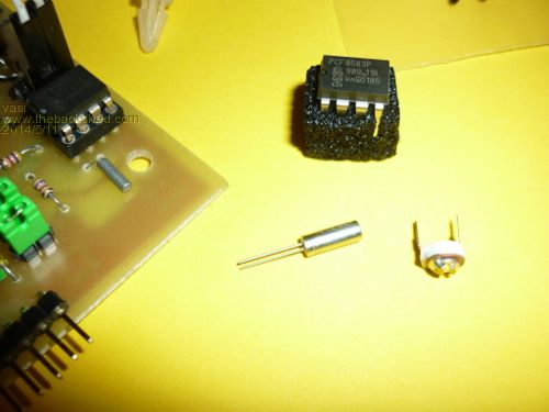

vasi
Joined: 23/03/2007
Location: Romania
Posts: 1697
Posted: 09:40am 11 May 2014
Finally, I found the envelopes with the components! Now the AVR evaluation board can get her RTC back. But, I think I want to save the crystal for another project... Anyway, it would be there if something goes wrong again.
There is an obvious difference in size between crystals, that's why I had my doubts at the beginning.
