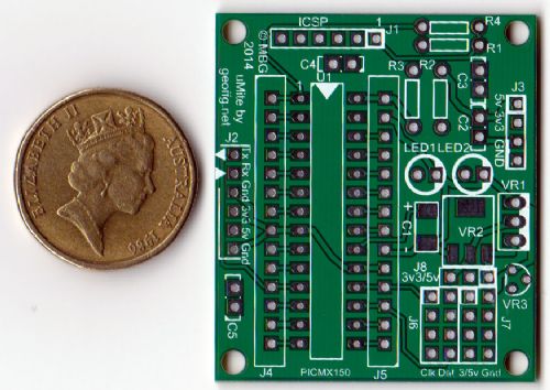

Gday Lads,
The MuP (Mick's uMite PCBC) PCBs have just arrived.. and I must saw they look excellent.
Now the big build and smoke test.. Although I have gone over it many times and not found any tracing problems, you never know.
I have decided that costing will be $3 per PCB and shipping is $1 per order in AUS and $3 to most other countries. This freight would allow about 5 PCBs to be sent in a standard letter with no insurance. Payment is via paypal (or beer), or cash if anyone has any these days.
Each PCB weighs 7gm and an air mail letter is supposed to be 50gm or under at that rate (and goes up on a logarithmic scale over 50gm). It would be cheaper to send 2 lots of 5PCBs if you needed 10 PCBs.
I will keep you posted on how the build goes.

Great looking board Mick. I love the creativity on this forum!

Errr Mick, what's that brown thing next to the board in the photo?

I'll hazard a guess and say an 18c coin afterall the rest goes in tax's.......
Nice looking boards too Mick

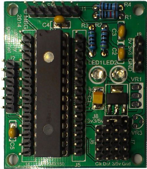

She LIVES!
Here is a pic of a built up one..
I flashed the v4.5 Firmware into the PIC using the ICSP header (a song and dance as for some reason my pickit3 stopped working on win 8.1 but thanks to my win 7 box...) I have also tested the Console for communication and tested all outputs (one at a time) and it appears to work as expected.

Well done Mick
Board looks great

Thanks Jman,
I appreciate that..
It was a piece of cake to build also ... took me about 30-40min.. (after scrounging in my pile of junk looking for all the bits)

Nice looking unit. I'll take 5 boards if thats ok for the UK.

It is supposed to be GOLD (AUS $1 coin) but you are right with the way tax and utility charges are going here it is worth a lot less but then the physical size is still the same so for size comparisons it is still valid.

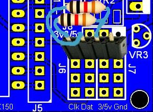

If I get another batch done I will try to add pullups for the I2C, They are missing on the one on offer now, not that it is a major problem.

@Mick,
  Quote  If I get another batch done I will try to add pullups for the I2C, They are missing on the one on offer now, not that it is a major problem.
That would be ok for low speed I2C but if things change and higher speeds are catered for, lower values of resistors may be required. I use a 4 wire bus and plug in the appropriate resistors on a spare header on the bus.
David M.
Posts: 3372
Posted: 11:00pm 28 Apr 2014
If you add fixed pullups they will interfere with using the I/O pins for general duties (ie, non I2C).
Posts: 2984
Posted: 11:33pm 28 Apr 2014
Hmm,
Thanks Mobi, Geoff,
Both good points.. I knew there was a reason I forgot to put them on the PCB..
Excuse the bad quality picture but I had as one option something like this on one of the sets of 4 pins I assigned for I2C. I intend to do a proper photograph of one to include in the manual (Well Maybe closer to documentation than manual) but I think the idea is clear enough.
The only other thing I thought of was a possible 1k resistor on the RX console if a 5V TTL adapter was used but even that there are times when you want it and times when you dont. It is not hard to add a resistor to your cable if you need it..
I think I have to bite the bullet and get some more done as it has only been 1 day and I am down to 15 left.

My I2C connector on board have jumpers for the pull-ups.
http://myshed.files.wordpress.com/2012/09/sanguino4-2.png
http://myshed.files.wordpress.com/2012/09/p1070689.jpg

Hi Vasi,
Good pictures, but it looks like someone has chewed the top off your RESET switch..
Your PCB is much larger than the MuP and to add extra jumpers and at least 2 different types of resistors (depending on speed) is really not an option.. Whilst I think I `could' squeeze it all in the clutter of jumpers would then start to be very confusing. Better to keep it neat and simple, I think.. after all you can always mount the pullups on the target device..

1. Pullups could be optional via jumpers or solderlink.
2. Same for the 1K resistor on the pin12 Rx line in.
