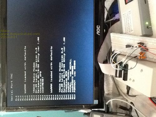

Posted: 08:36pm 20 Apr 2014
Easter slowed things up a bit... But just wired up the MAX232 chip up. You were spot on with your diagnosis! It now works a treat! Thank you !
