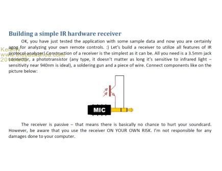

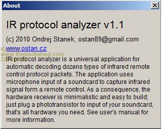

I have used this protcol analyser. There are limitations but you will be able to monitor with it the signal from the Micromite vs the signal from your remote.
It did not correctly decode the signals for me though. Worth a look. You do require an infrared transistor. The site is shown on the ABOUT. Hope that you can read it.
www.ostan.cz
Keith W.Edited by Keith W. 2014-04-16

i used the IR Analyzer from the link above ( thx Keith) .
it gets the commands in 50%. in some loops the time for the bits are longer as for the recognized codes.
time shifts a bit , maybe this have todo while micromite is running without a quartz.
