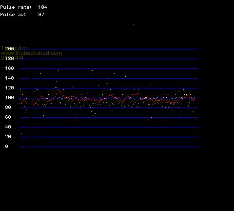

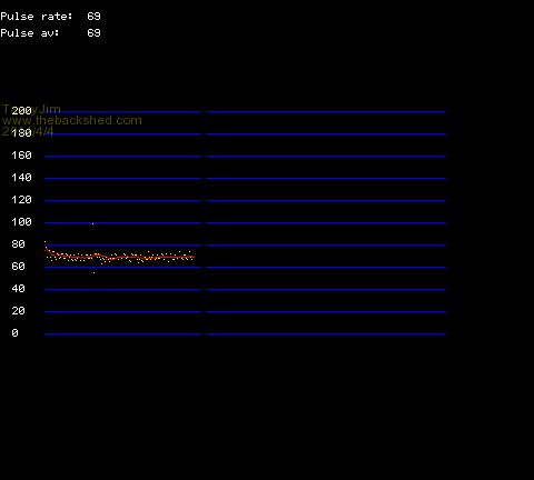

The first screen dump is from a 'normal' heart rate while the second one is mine.
It would be fair to say that the maximite has saved my life!
