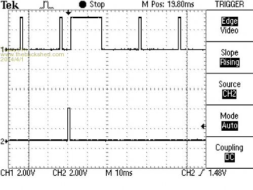

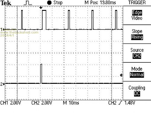

I don't have a servo to test with but I did see some strange jitter with the CRO
The jitter was not always present but here is one which I was able to capture.
The middle pulse came in 2 ms early and is 2ms too wide.
Here is another example with the oddball pulse coming in very early and staying until it's correct end-time
I will try and work out when the error occurs. I expect it is when the pulse width gets updated but I hope to confirm this.

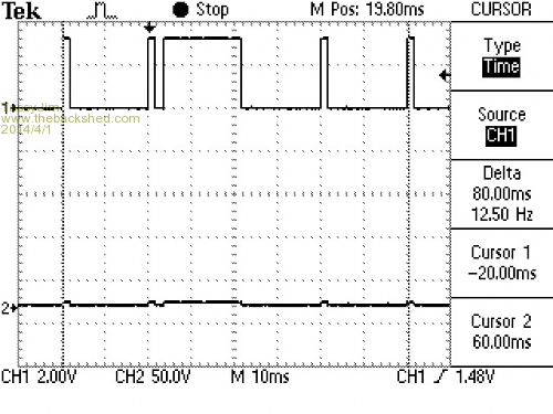

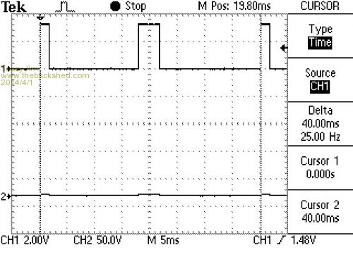

Posted: 07:25pm 31 Mar 2014
I changed the program to send a pulse out each loop to act as a trigger for the cro.
' servo test
p=1.000
setpin 24, 8
Servo 2, 50, p
Pause 200
p=p + 0.01
Print p
pulse 24 , 1
If p=>2 Then p=1
Loop
The top trace is the PWM and the lower trace is the pulse on pin 24
and another:
In both cases, the long pulse coincides with the change of pulse width.
