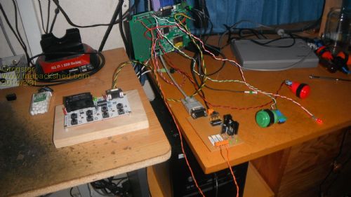

Well, I am just experimenting here....
I was going to design my own MM clone, but at the end of the day, I decided it was far less trouble to just use a ready-made module such as the CGCMM2.
Despite the wires all over the place, this is a fully functional system, and the FIRST successful test of which, I have been writing for about one year.
It is almost better then sex(almost!) that it is all working from one end to the other now.
EDIT: Used to be able to put reasonably big photos up here, but no matter what, my image is being re-sized. Sorry, folks.... Edited by Grogster 2014-04-01

  grogster said  How to wire a CGCMM2
Is that a question or are you just bragging because your work bench is infinitely tidier than mine?

Hi Grogster,
Ok it looks very impressive but I am curious as to what it does!
I see your little 'Serial test message' module on the left. What happens when you push what look like the big buttons (red & green ones assuming they are buttons)??
And is that a glass of beer in the top right hand corner?
MaxiMite Home brewing kit maybe . . .

Crikey - did not think this thread would generate such interest, it was just an attempt to show how messy my wiring to the CMM2 board is - the "How to wire a CGCMM2" is a play on words, cos it is NOT neat, and ideally should be neater and tidy etc.
However, everything is working on it. It was my night when I posted it, so no replies from me till now, which is my morning.
It is the security system I have been working on for the last year, perfecting the code and finding and squashing bugs.
It allows an administrator to edit/delete/create message, logs anything that goes through it on a day-by-day basis, reads messages from the SD card, and sends them to pagers, although, this is likey going to move to TXT messages to cell-phones very soon, as pagers are 20-something year old technology, and are hideously expensive these days, compared to a nice cheap cell-phone, which can be had new for about $20, and if all you REALLY need is the SMS ability...
Red button is reset, green button is just a way of simulating a power failure - this will be connected to a relay powered from the system transformer, so that NO becomes NC, so to speak - if the relay drops out, it tells the system, which throws up a message, and the other pole of the relay is used to set off a power-failure beeper.
Anyway, I just put up the photo, as I was able to actually get messages from one end(the message generator on the left) to the pagers(via transmitter connected to the DB9 cable coming off the 232 level corrector). I could have(and will in the final version) used the on-board 232 converter on the CMM2, but the wee board I am using already had the DB9 on it, making it nice and easy - at the time - to connect to the pager transmitter.
All that messy wiring and relay, LED's etc will be on a supplementary board I am designing, which will mount on the CMM2's "Sea of holes" - it's unused space, but a nice area to mount a small additional board of tricks.Edited by Grogster 2014-04-01

Pagers are getting harder and harder to find - and thus quite horribly priced.
That, and the pager transmitter costs about $1,000 and you also need a license from the Government to transmit, if the power is greater then 500mW - that's another few hundred bucks.
TXT messages on the other hand, are essentially free, if you get yourself a plan with unlimited text per month, and txt messages are so much more reliable then they ever used to be before, I think this is the way to go now. There used to be the odd time that a txt message was dropped or could not be sent, but I can't remember how long it has been now since I got one of those failed message messages on my phone - it's been several years at least - all messages always come and go fine.
Regardless, you can always query the GSM module - it will send an "OK" if sent, or some kind of error code if it can't, which the system could read and retry with etc.
