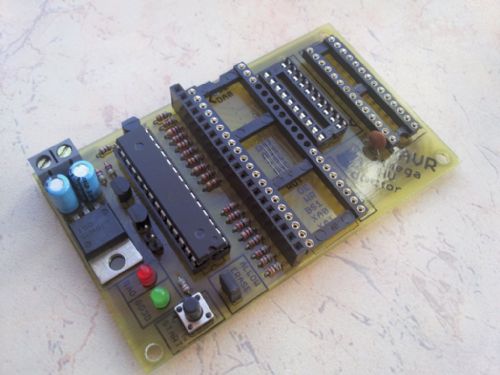

As a beginner, I bricked an ATmega32 40 pin microcontroller. It was my first attempt of going beyond Wiring language. The story is a little longer but to tell only a summary, I tried to write something on a 16x2 LCD using some "C" example. I got only garbage on display so, as a Microchip PIC programmer, I thought it may have something to do with the frequency settings (as you do bit configuration inside PIC). Of course, I got the fuse bits wrong and ignoring a warning message, I disabled the possibility to program the chip any further and disabled also the reset capability because my "math" was "correct" and I knew "better" than anyone. I threw the chip in my toolbox, got an ATmega644P to transform it into a Sanguino, and this time, I got it right.
But I want to use also the ATmega32 as I need to test the portability of my libraries/applications so, I searched for a parallel, high voltage programmer as it is the only method to revive an ATmega. I found that any option regarding a full featured HVP programmer is expensive or relatively difficult to build. So, I tried to find some automated "revivers". Those are some kind of HVP programmers but they manage only the fuse part (erasing chip, reading, writing, verifying fuses). It does need only a 12Vcc power supply as the firmware inside contains a little database about the chips it covers.
And I found it. Is free for personal use, easy to build, it covers 145 MCUs and important for me, the firmware is available also for ATmega168P MCU which I had available. Who cares it is not open source as long as you end up having your own AVR fusebit Doctor?
Now, to find the time to build it...

But, if you can't go over "open-source" issue, here is an open-source alternative to the "AVR fusebit Doctor"'s firmware (written in Wiring language - just found it on Fritzing.org site). You can download it as zip archive - see the right panel. You have to download Fritzing if you intend to use your Arduino as a Doctor. Edited by vasi 2014-03-31
