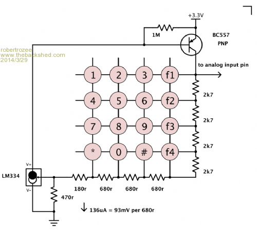

here we are, the mark 2 version. this time i've adopted a circuit first written about by Bob Pease back in 2000, in a column titled "What's All This Current Limiter Stuff, Anyhow?". it removes the V+/V- drop of the LM334 to outside of the current loop, using an external PNP transistor. in this configuration the set current is no longer given by I=68mV/R, but instead I=64mV/R. this is due to the V- pin current not going through the load (so i am led to believe).
i've switched to a 140uA current, and use strings of 680r and 2k7 resistors. the 180r + 470r resistors in the circuit, plus the switch resistance (in my keypad this around 20 ohms) combine to make up the bottom '680r' resistor.
even when a key is not pressed there is still a current flow, corresponding to a non-existent key "20". this serves as a calibration point for the software. there are no fixed voltages specified in the code, just a ratio, with everything self-calibrating whenever no key is pressed. the design should be more than happy working down to the minimum Vcc of 2.3 volts.
here is the circuit:
and here is some test code:

Hi Rob,
I really like this design, and want to build it right now but just realised I've not got any LM334's. So just ordered some on next day delivery but they won't be here till Tuesday morning thanks to it now being Sunday .
One question - Is there technically a way to 'store' the voltage output (i.e. the voltage on Pin 4 in your example), and whenever a 'significant' change occurs (i.e. a key pressed) then pulse an Interrupt to the uMite. Then remove the SetTick command so that the software is only responding to a key press rather than continually polling for one.
I am NOT saying this would be better - purely wondering if this is possible (as I was never any good at analogue electronics!).
Once again - a really nice design . . .
Posts: 2552
Posted: 05:25pm 29 Mar 2014
it would be technically possible (pretty much anything is), but would add to the circuit complexity. one could use a comparator along with a few other passive components to detect the drop created when a key is pressed. this output could then trigger an interrupt via a second (digital) input pin. but at that point one is using two pins, and a quantity of electronics that is fast approaching the complexity of a dedicated I2C keypad controller (or a second PIC). it was with great trepidation that i introduced the PNP transistor - the goal was to use the bare minimum of extra components.
for those interested, here is the original Bob Pease circuit. alas, Bob is no longer with us:
it makes for a great LED torch (Zl being a white LED) that is able to run with the battery voltage right down to within a fraction of the LED forward voltage using 3x AA batteries for the supply.
and i seem to have tracked down the source of the jitter i mentioned earlier. it was originating from my netbook power supply, and getting directly into the micromite. this explains quite a few odd things i have seen with the micromite's analog inputs. even with just a 220k pot strung between Vcc and ground (wiper onto pin 4) massive jumps in the A/D values are seen when pin 4 is touched by a hand:
