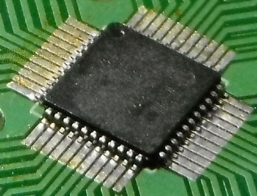

This image is the first one I soldered up using thin solder, gel-flux and a fine-tipped iron, and a VERY steady hand. It worked OK, but took almost an hour to finish pin-by-pin, being careful not to bridge any connections - NOT a good method in hindsight, and plenty of other members will no doubt mention that it should not have taken that long anyway, but..........
OK, that's my hand soldering pin-by-pin old method which - lets be frank here - sucks!

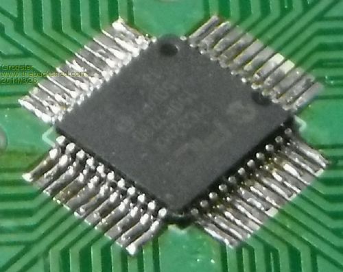

Next, with PM's from WW, I tried his method on another clean board and chip, and this photo was the result:
Armed with the right set of tools, this one took about 5 minutes for all four sides of the QFP. The method is dead easy, and seems to work extremely well.
I WILL NOT write the specifics of exactly how it is done here, as I believe that is WW's right - he told me how to do it, and it was at his request(in a PM) that I start this thread showing my photos etc, so I am fully expecting that he will fill in the details himself in a post of his own here.
But suffice it to say, that having tried the WW way, I am a convert, and will probably NEVER solder SMD chips again any other way then his from this point on.

Not knowing exactly WW's method but looking at the result it seems to me to be the SOLDER the entire side and use `solder wick' to suck up the excess solder method.
I have used this method and have had reasonable success with it. In fact I used this method to repair Nick's (where are you these days Nick?) CMM for him when he blew up his chip. But you do have to be careful that all joints are soldered as the `solder wick' has the habit of removing ALL solder from the joint. Ideally the joint should have a little `fill' either side of the rear and front of each pin... This is patently missing off many of the pins in your 2nd photo. In fact your first picture may actually be more reliable, if more ugly. If you do use the Solder wick method you MUST check each pin is firmly soldered by a needle (as suggested) or a fine scalpel (as I tend to use) and listen and feel for pins that dont seem the same as the others (It really is noticeable).

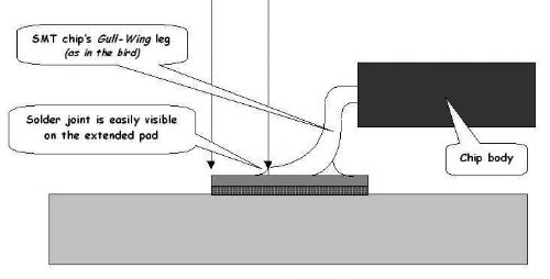

A perfect joint should look like this picture..
Of course it is all a matter of trial and error and I cant say that I do any better than your efforts either..

Yeah, you are right about the lack of solder - This image WAS my first attempt.
Next time I do one, I will try to leave a little more solder behind.
My prototype boards have long footprints, as I had seen a video on YouTube about how if they are long like that, you can apply a tiny bit of solder to each one, then use the iron to "Shunt" the solder up to the QFP pin - might try that.
Most QFP footprints DON'T have these extra-long pads though - that was just me stealing the idea from the YT vids.

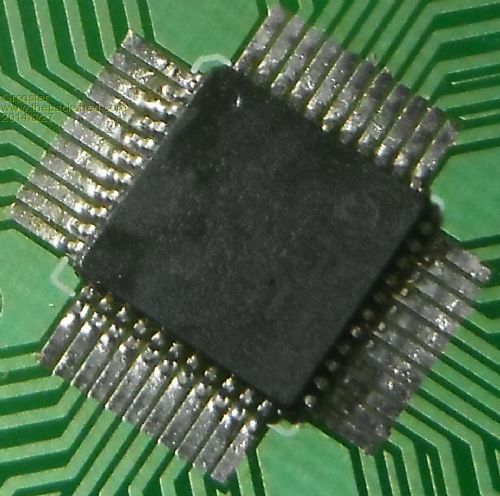

...and here is my second attempt at the WW method - better results this time, as I was able to leave more solder on the pads...
Posts: 2984
Posted: 06:29pm 26 Mar 2014
Beautiful work Groggy,
Now that is definitely good work..
Well Done!!
