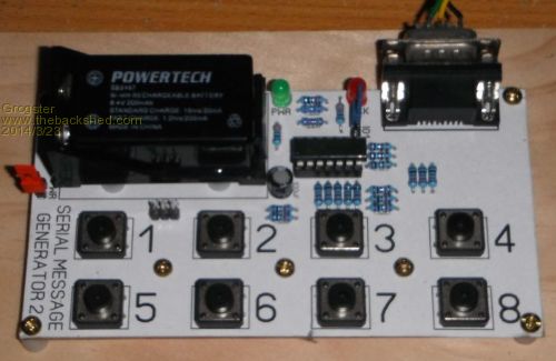

Perhaps you need a serial message generator?
I made one of these, and it makes testing so much easier, if you can generate "Fake" messages with which to test with...
This is based on a PICAXE 14M2, and you can program it to output any message you want, on any of the 8 buttons - I have the coupled to the Colour Maximite at the moment, and I can send it any one of 8 messages any time I press a button - also useful for sending multiple messages, and seeing how the MM serial buffer deals with it.(very well, actually!)

Posts: 10105
Posted: 12:56pm 23 Mar 2014
  Nixie said   Your point is well-made. I'm stuck in stem driven code, can you recommend any particular text book? You are right...I need to work with structured code I have let things slip somewhat!
As for your message machine, that is great! (It's time I also learnt how to PIC program) would you share how you built your test message generator?
Many thanks, Nic
I am not trying to force you down the "No line numbers" path, but perhaps I could encourage you to walk with me and others down this path - we'll all help you if you trip on a rock or something!
I HATED the idea of dropping my much loved line numbers from the likes of Atari Basic, as I essentally learned BASIC on my old Atari 800XL back in the 80's, and it had line-numbers, and no structured loops etc, so I was loathe to leave it in favour of this new fangled line-less coding rubbish.
But my examples above are just one example of what you can do easily with a structured loop, which you can't do easily, with line numbers.
Posts: 10105
Posted: 01:01pm 23 Mar 2014
@ Nixie & WhiteWizzard & anyone else interested:
Yes, I designed and built the serial message generator myself a few years ago. I used PICAXE, as that was what I was into at the time. A MicroMite version would be easy to build though, and would be the chip of choice had I to build it again now. I would also replace all the throuh-hole parts with SMD - using the SOIC MicroMite chip, and 1206 SMD resistors etc.
I have OFTEN found, in my playing around with serial, that it is really handy, if you can just press a button to send a "Fake" message while you are trying to perfect your code. You could always use a laptop and serial program to do the same thing, but this is much smaller. I also have my laptop hooked to the other MM serial port, as when I press a button, the MM process the message, and then outputs a corresponding message to a pager transmitter on the other port, so at the moment, I am using the laptop and terminal software as a pager transmitter mock-up, to make sure the correct data is both going in and coming out.
I have been able to test my message system on the MM, by pressing ALL 8 buttons one after another in quick succession, to fill up the MM serial buffer, then watch what the MM and how my code deals with it - nice easy way to build a message queue, if you are testing message queuing, which I am. To say nothing of the fact that with a laptop instead, you have to type the message, having to just push a button is much quicker.
I can upload gerbers and PICAXE code, if anyone is interested in making their own one.
